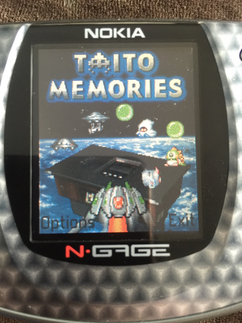

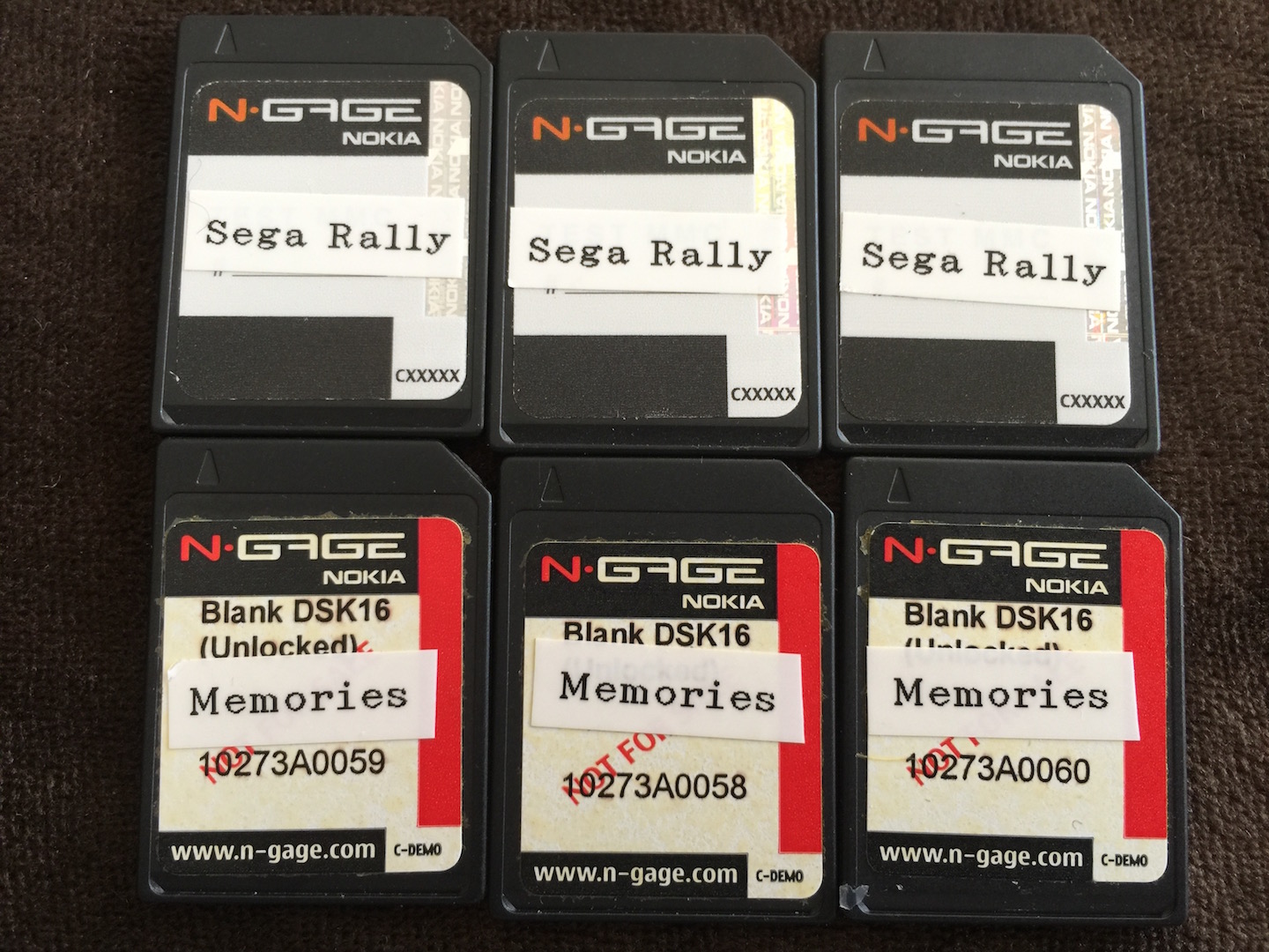

    I have 3 N-Gage Development MMC cards with different builds of Taito Memories on them. I also have 3 cards with builds of Sega Rally. These are not like the normal alpha/beta carts that I see pop up. Normally they have the name of the game typed out on them and are somewhat legitimate. The ones I have are Nokia memory cards with labels over them (Picture is attached).

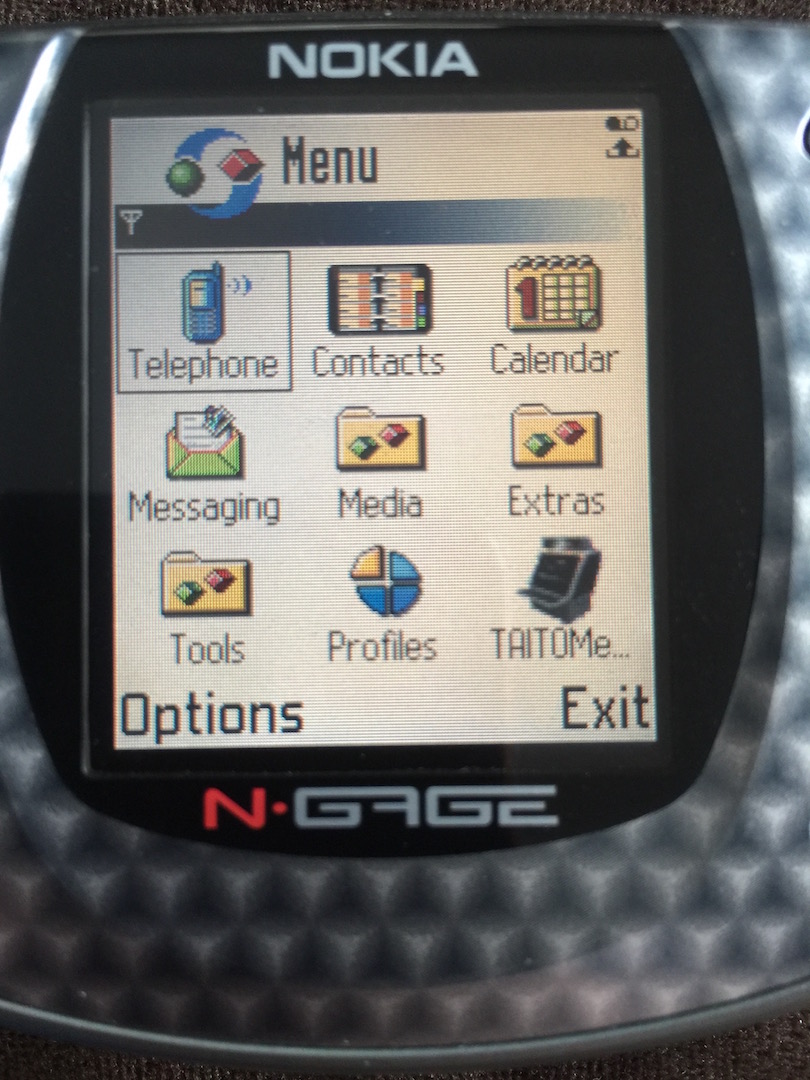

    Unfortunately these carts aren't fully working right now. They are meant for a development N-Gage console and look for a license file when the game starts. The games will launch and run for ~10 seconds and then come up and say memory card corrupted and the whole phone reboots. The cards are definitely not corrupted. If I am fast enough I can actually navigate through the menus and start playing before it kicks me.
    I would like to get these games up and running so I can release them on here for anyone interested. Does anyone on here have the ability to assist me in getting these running first?
    So far I have attempted to dump a retail copy of MLB slam and did a hex comparison with a cracked copy to see exactly what was done to get the game running. I did the same edits to the Taito Memories app and it did not work. I'm thinking there is something in there that a dev game has that needs to be patched as well.

    No emulators currently. There is one but it can only play java games for the Nokia platform and not actual N-Gage titles. Once the game is patched you can put it on an MMC card and play it on an actual unit though. Looks like we are going to be able to get this patched and out soon.

    There was many N-Gage prototype leaks at the time, the games certainly aren't corrupted that was just the default error message from the protection scheme. I've sent you a message :) It's quite an interesting little handheld because of the cancelled games and how hard it is to obtain some of the dev copies.. some only turned up in specific locations like Australia.
    I did speak to someone else with beta copies and to be honest i was too pre-occupied to re-learn the cracking method i think they ended up doing it themselves, but we can talk and i can give it a go for you. MLB Slam to my memory was cracked by Blizzard who used a different method entirely and packed their games in their own loader which used .blz files.
    And yeah sometimes the errors were inside the game not immediately, the main .app is not the only file which needs cracking, and it was overlooked sometimes that one of the library files also causes the errors.
