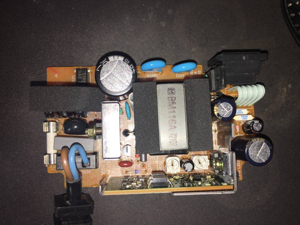

    I got a nintendo 64 off my friend the other day and it wouldn't power on but l did manage to borrow another friends power supply and it worked so l'm wondering if its possible to fix the current one l have?
    I cannot see any signs of a blown power supply and unfortunately l don't have a multi metre. Is there anything you guys can suggest or am l just better off to go and buy a replacement n64 psu?

    I would say it might be best to acquire another power supply that matches the mains voltage in your country - preferably Nintendo branded. To diagnose a switch mode power supply (smps), an o'scope for waveform analysis is more appropriate than a MM. Do keep some things in mind when messing with this N64 power supply on a non-conductive work surface:
    -Ground/negative reference is the large heatsink below transformer
    -Do not touch the top of the large capacitor or the adjacent smaller heatsink with hands (either would read in the ballpark of 80V pulsating DC or even AC) it can zap even after unplugged
    -check 120/240V mains fuse
    -check the 3.3V and 12V fuses, located to right side of transformer (below connector to N64)

    Would like to find a fix for these I have a stack pile of psu like these all fuses are checked.
