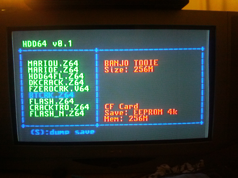

    Hi,
    i have had this code for quite a while now collecting dust on my hdd, plan was to make it bit more polished and with more features
    before initial release, but cos of tight time schedule with uni and all, i decided to release an early beta and see if there is any interest at all in
    this kind of obscure software.
    It's essentially a bios replacement for the cd64 copier, that reads game files from hdd instead of cdrom.
    Read the included text file for more details.
    https://mega.co.nz/#!Hd1UmaKQ!cMFPjExwOtB8TKhtYwC-txIFOTsIlEsKHGtcwyUHkBw
