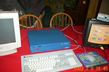

    What exactly is this and how rare is it, what does it usually go for? :lol:
    Many questions, i know...

    looks like the sgi workstation...
    Seems to have a copy of Mario 64. I can't tell the language. It'd be interesting to own, seing as how nintendo prototypes rarely get out.
    Looks like there's some sort of camera on top of the TV (tv looks like it's a sony, lol).
    This is the same kind of workstation that the Final Fantasy 64 was demoed on... *ducks*

    Depends from whats in it...as far as i recall the picture you got is prolly a fake (but i am not sure). Anyway, its one of the first N64 dev kits that came across the land (and one of the expensivest). I have a complete set, (that means indy + U64) and it costed me merely 150 €, 120 of which for the Indy (which is a R5000 166 MHz if im not wrong with 128 MB RAM) that camed with IRIX, Digicam and various client apps+ dev libraries....it took me some time to get that to work since the indy was diskless. I got the U64 board from Akihabara (via a good jap friend i met on Nekochan). I personally dont know how much it would be worth, but i wouldnt sell it for less than 250 € - 300 € for everything, monitor adapter included methinks. Not that i want to sell it, tho ;)
    The normal kit would include:
    Ultra 64 board + Joypad extension
    U64 SGI OS (my version : 2.0K)
    Documentation (HTML, Man)
    Code Examples

    That's the standard Indy cam :p
    Yep.... *ducks too*
