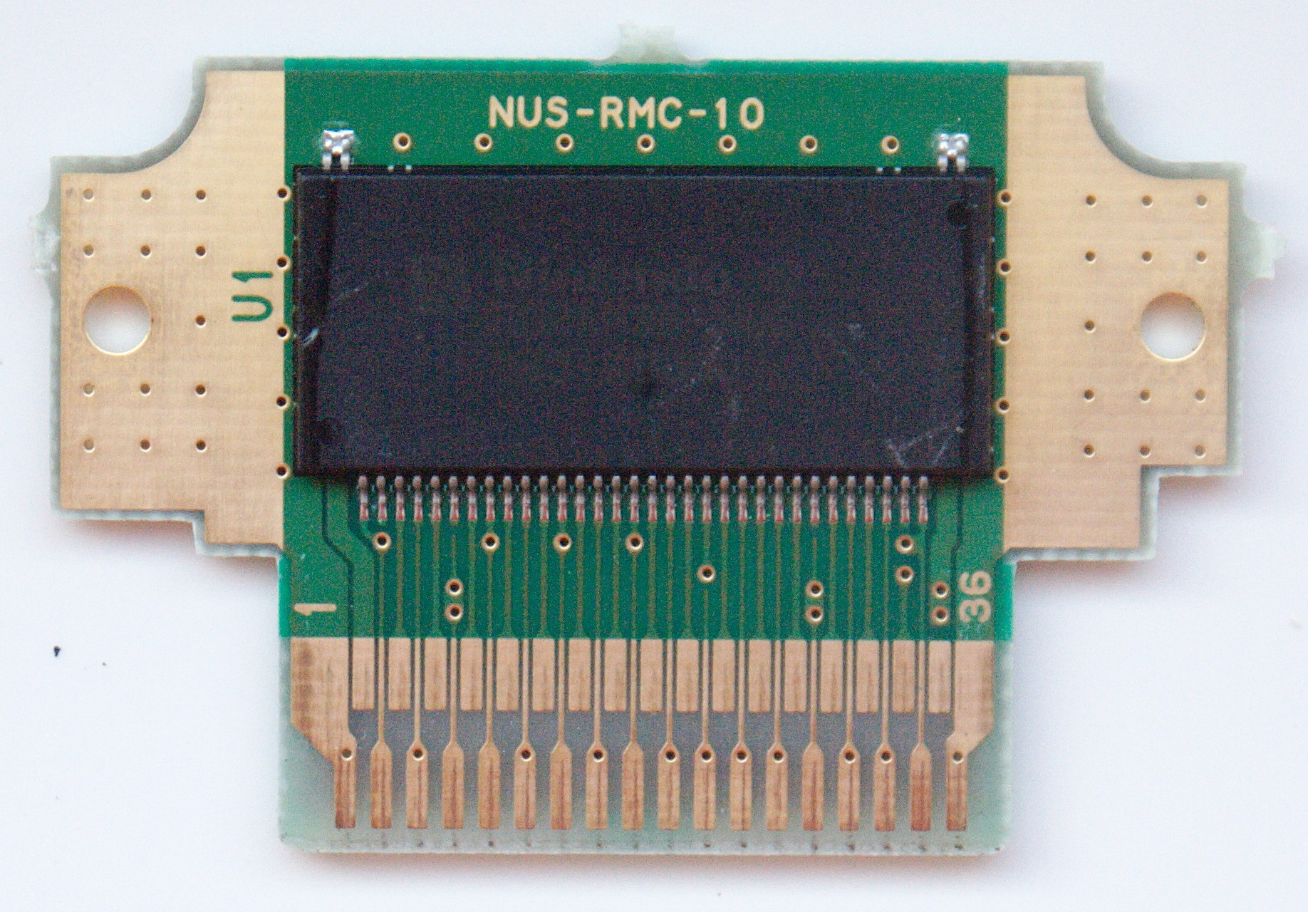

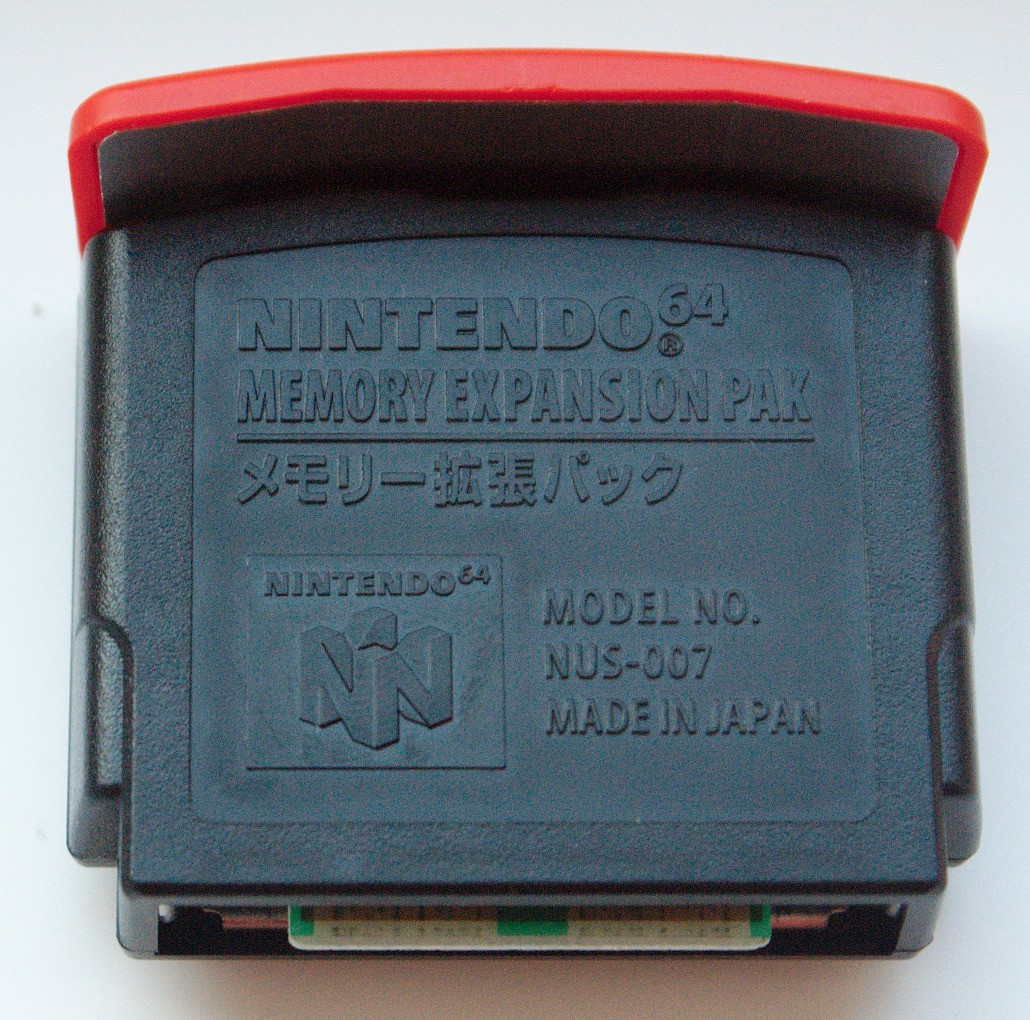

    I'm needing to source some official Nintendo brand DRAM. So I decided on using official N64 Expansion PAK's which seemed like a perfect solution. So, with that said I'm trying to gather info and HI-Res Photos for all the various versions of "N64 Expansion PAK's". Primarily Photos of the PCBA's revealing both the PCBA model numbers and also the DRAM model numbers.

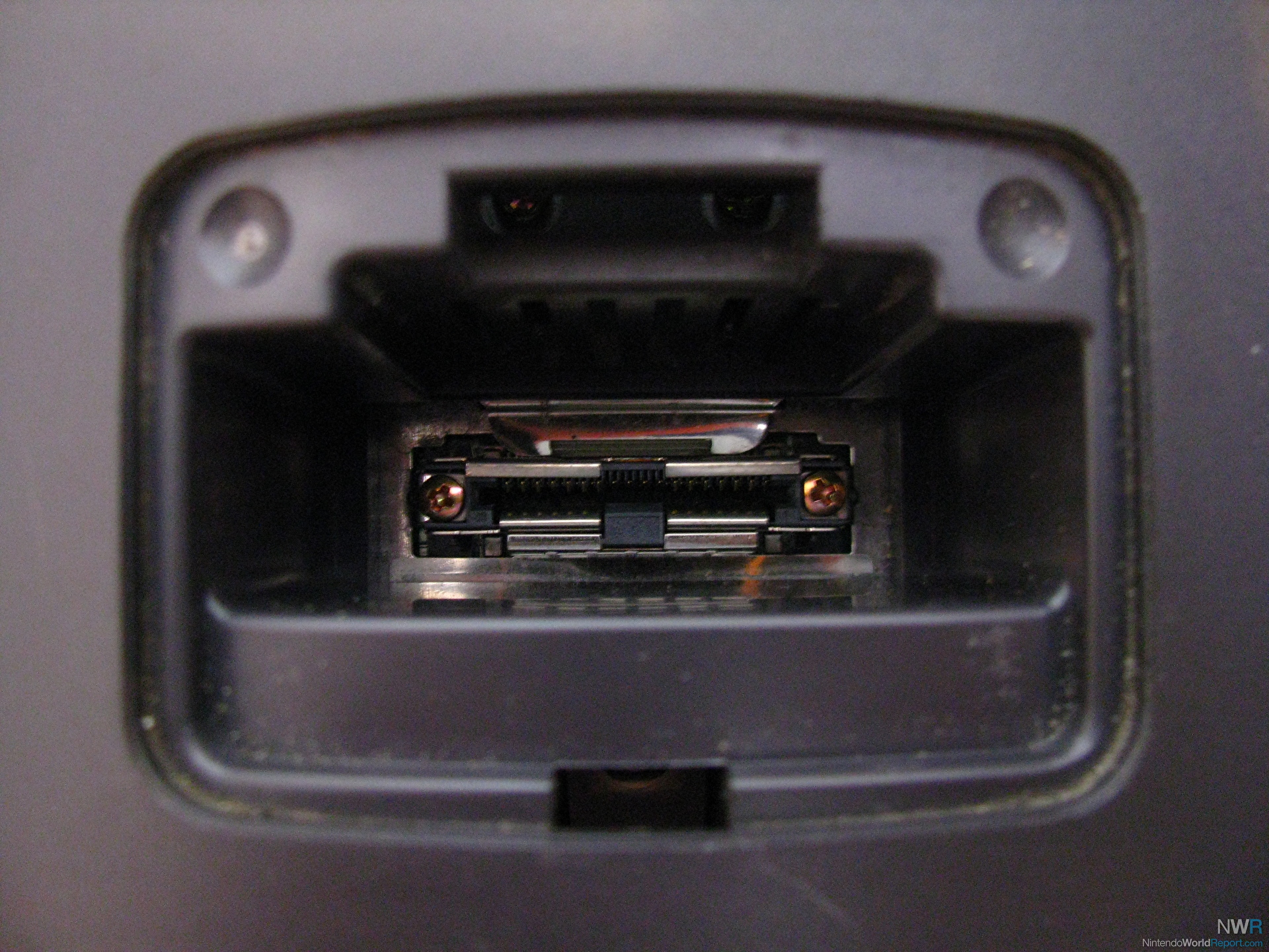

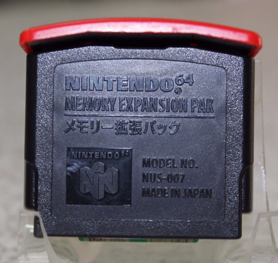

    Shown below is the official Nintendo Brand Expansion PAK model# NUS-007
    So these Expansion PAK Modules are the DRAM modules that insert into the top of the N64 console.

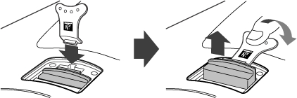

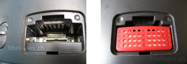

    Remove Default JUMPER PAK using accessory tool...
    Insert N64 4MByte Expansion PAK...
    These are used to increase the system RAM from the default internal 4 MBytes...up to 8 MBytes which is used for specific N64 game titles and also for all 64DD games..... and is also a requirement for 64DD development.

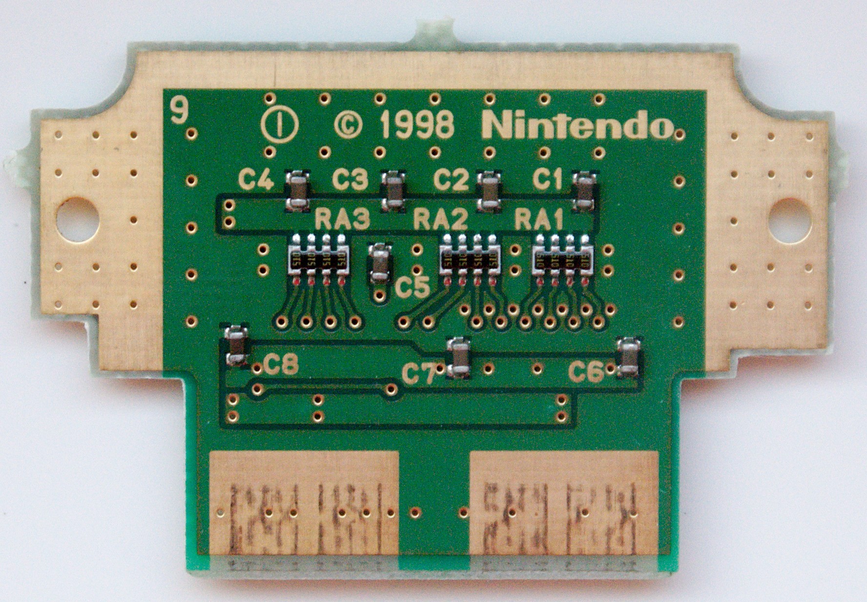

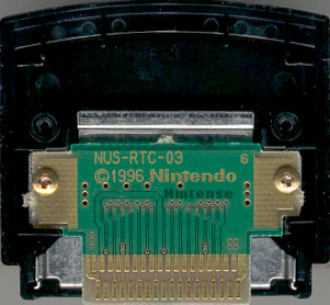

    Now the N64 console arrives with a redundant terminator module inside the consoles expansion socket. This BUS terminator module is called the "N64 Jumper PAK" and simply allows the console to function correctly with the default internal 4MBytes of DRAM.
    These Jumper Pak's simply house some surface mount Resistor arrays for BUS Termination.
    As shown further below:
    [​IMG] [​IMG]
    PCBA Model# NUS-RTC-xx (There were a few different revisions.)

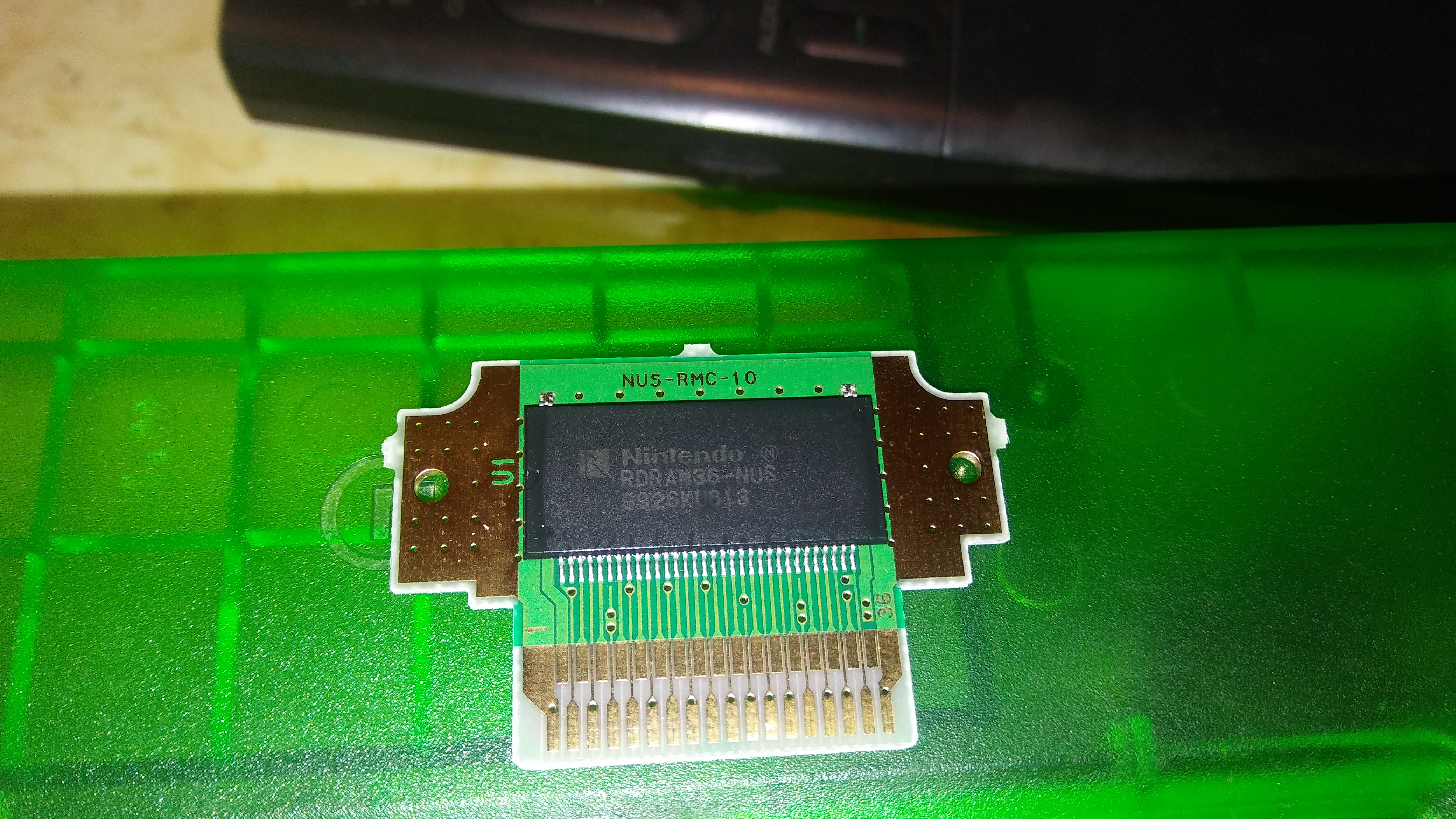

    Now going back to the DRAM Expansion PAK's, from what I have researched the official Nintendo Brand Expansion PAK's have a PCBA model# NUS-RMC-xx and usually house a single DRAM Chip model# RDRAM36-NUS As shown below:

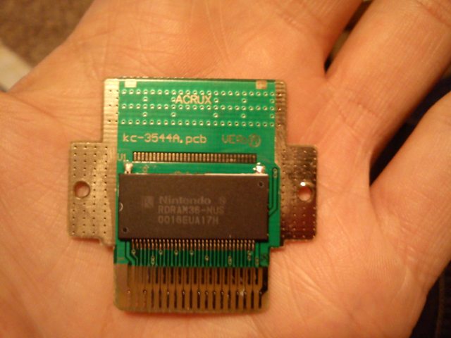

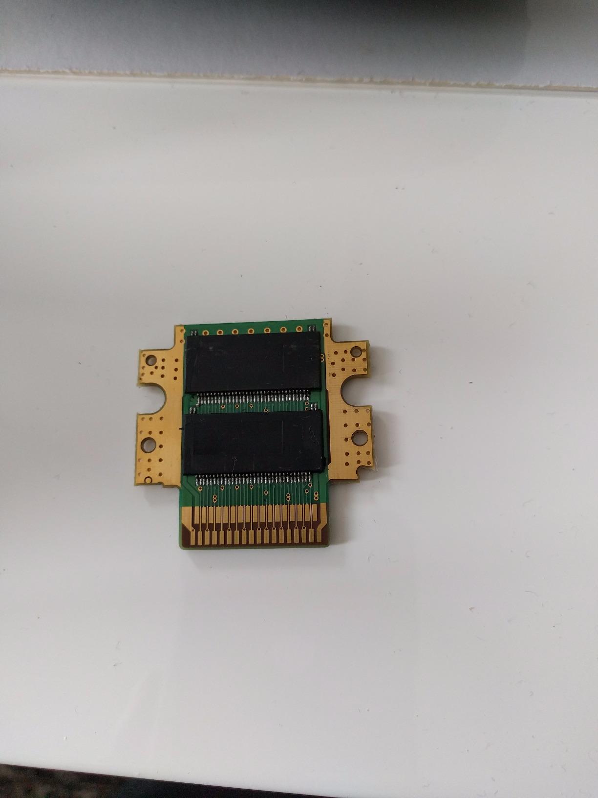

    Now I have also read about certain 3rd Party Expansion Packs that will house a PCB that can accommodate (x2) DRAM chips. Usually two RDRAM18-NUS to make up the 4MBytes. However sometimes they will just install a single RDRAM36-NUS and leave the second chip footprint un-populated. As shown with this "YOBO" brand Expansion PAK PCBA.
    Now...I have not actually seen a photo of a particular N64 Expansion PAK that does in fact house (x2) DRAM chips within it.....does anyone have a Photo of one ?
    I'm hoping everyone here could give me a hand if possible to collect some more info and Photos....?
    For those of you that do have an N64 Expansion PAK...official or not....if you could pop it open and take some Hi-Res Photos of the internal PCB with the DRAM chip... both front and back...and also include the Model number of the Expansion PAK that it belong to. Then post it here in the Thread for the archive...that would be appreciated.
    I'm hoping someone here may have photos of one that actually has (x2) RDRAM Chips inside. As I have not been able to identify the PAK model number that does use two chips.

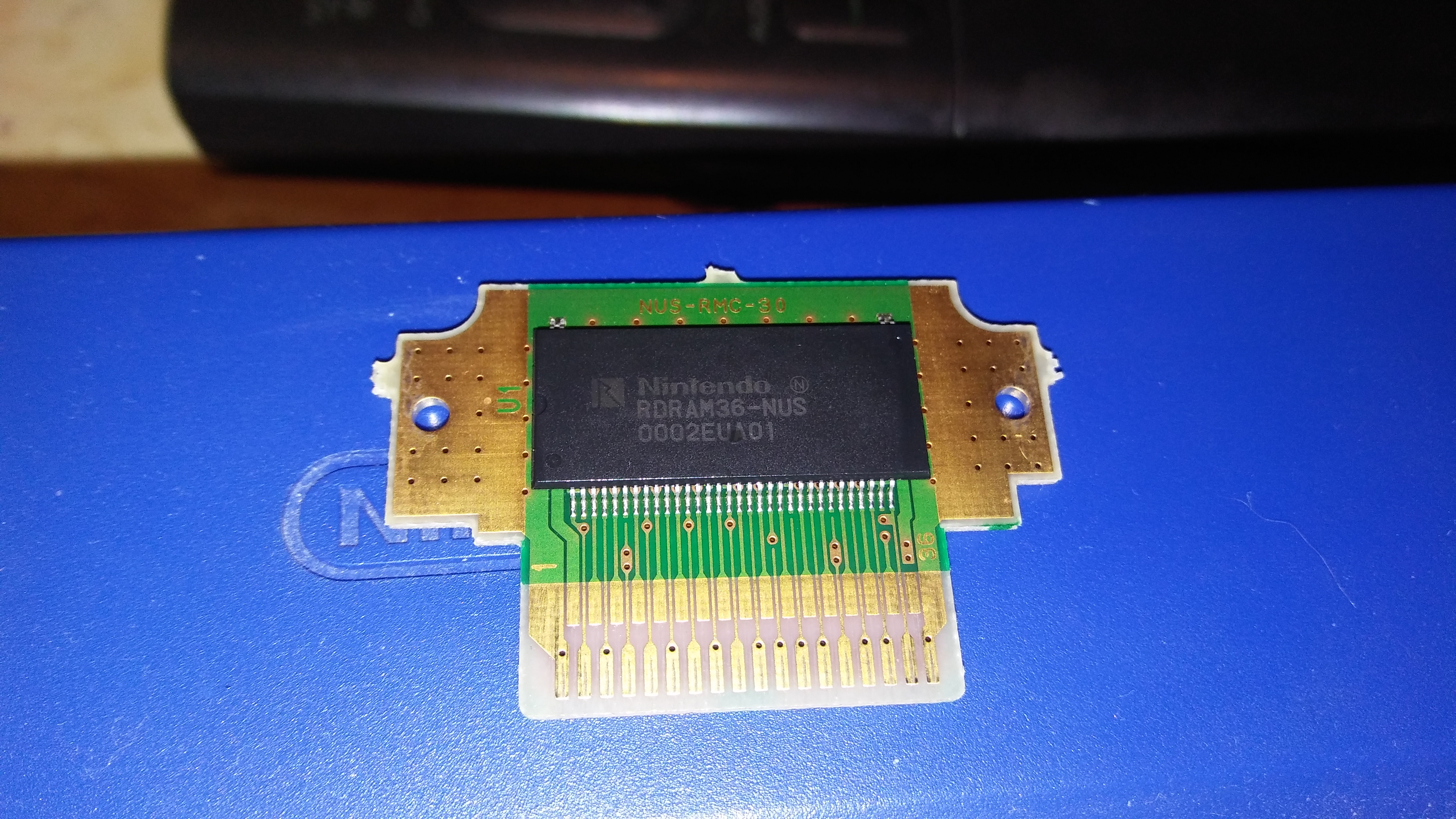

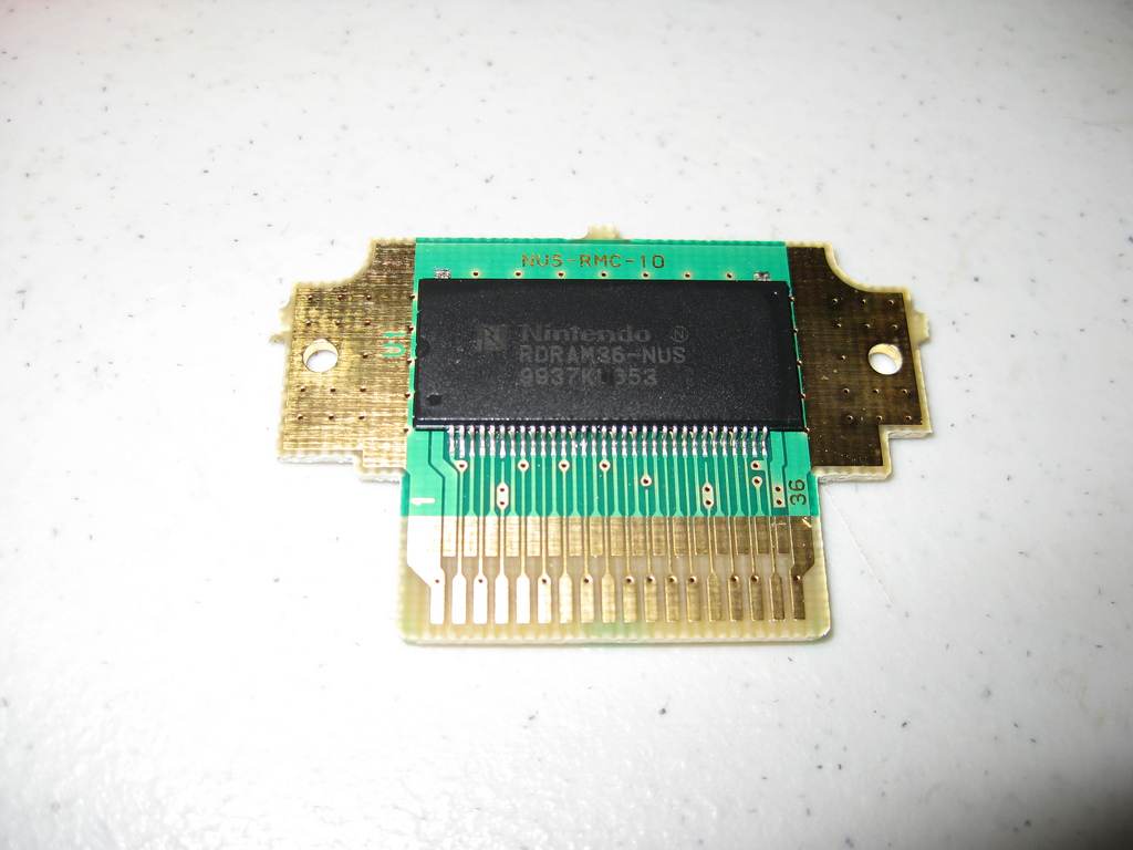

    I have two official paks, apparently identical to yours - NUS-007 w/ NUS-RMC-10 PCBs.
  3. Gerry_MAN
    Gerry_MAN N64 Hardware Fanatic
    Dec 26, 2010
    171
    245
    Yeah...they are definitely unique.
    As indicated in the datasheets....
    the top 4 corner pins are strictly there for mechanical support.
    They serve no purpose in terms of Logic functionality.
    Thanks for posting those pics.... :cool:
    Cheers!
    -Gerry

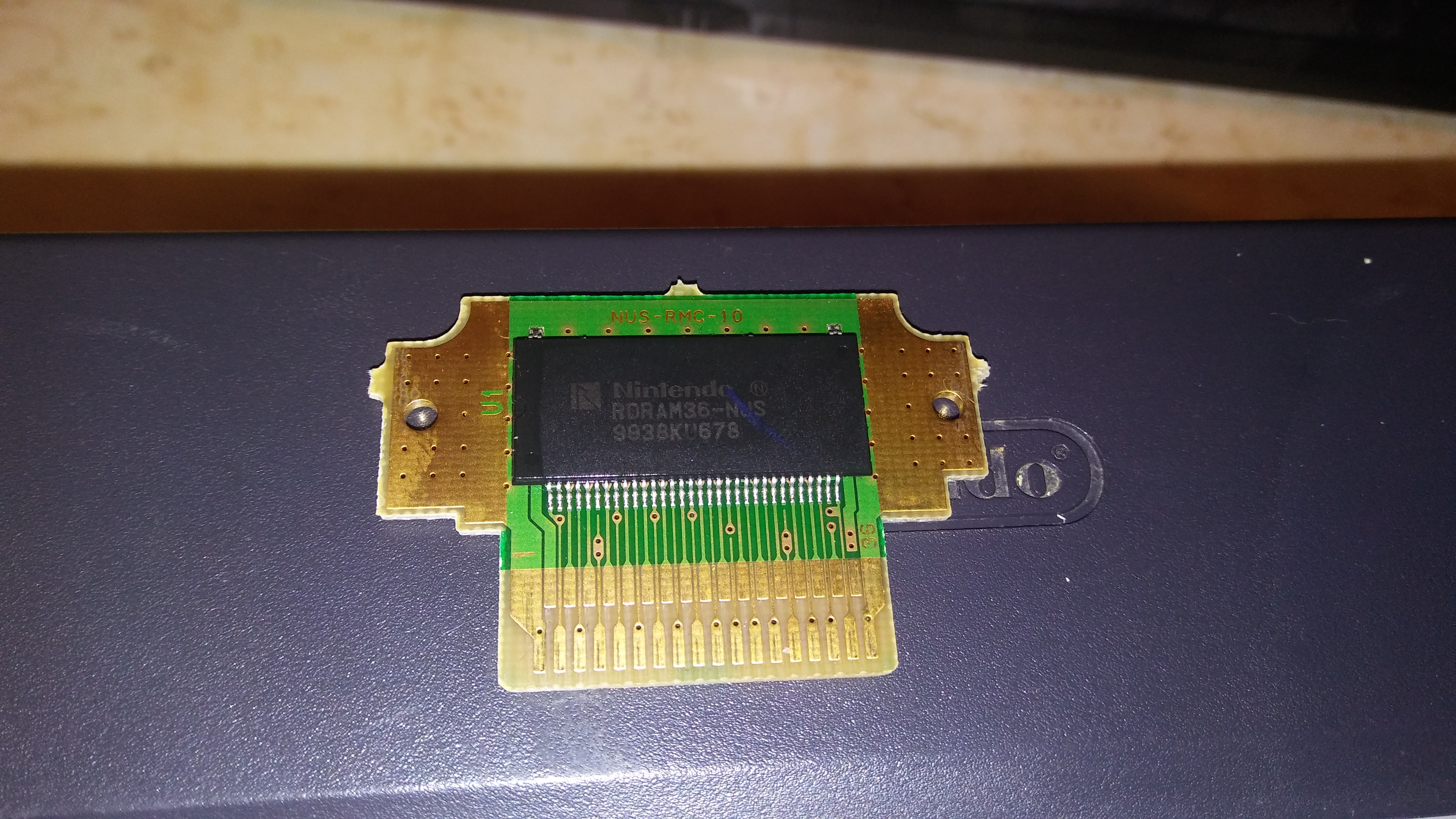

    Here are three official ram packs! The one with the blue blackground has a copyright of 2000.
    All are NUS-007.

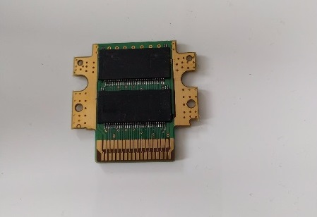

    So I found this pic in a customer review section on an Amazon page selling N64 Expansion Packs.
    https://www.amazon.com/Nintendo-64-Expansion-Pak/product-reviews/B00000INR2
    This Lo-res image still points towards a cheap knockoff. The PCBA has no model# and the user review indicated that the DRAM Chip serial numbers were too blurry to actually read. He assumes this was done intentionally by the scammers. I guess it is possible that Nintendo always did use a single RDRAM36-NUS chip.... for all of their 4MByte Expansion PAK's........??
    We'll have to wait and see if someone else comes forward with a better hi-res photo that actually shows a Nintendo PCB model number and (x2) official Nintendo DRAM chips.

  8. rso
    Mar 26, 2010
    2,190
    447
    (attached the higher res photo from that AZN listing for posterity)
    I don't see why Nintendo would move away from a single chip solution. For cost saving reasons? Nah. They may have changed the chip, but I believe it's very unlikely that going with that a second chip would ever end up being cheaper... Chances are you'll only see the two-chip PCBs in third party products (and fakes) whose producers may not have had access to higher-capacity chips, or who had no qualms about cutting it awfully close wrt signal quality (due to the longer traces on the larger pcb) or whatever.

  10. marshallh
    marshallh N64 Coder
    Mar 16, 2006
    661
    26
    Is the indy board not working?
    Nintendo branded and licensed expansion paks always use 36mbit chips.
    N64 motherboards from NUS-CPU01 to 05 use two 18mbit chips, 06 to 09 use 36mbit.
    3rd party and knockoff paks almost always use two 18mbit chips.
    Early versions of the Ultra64 GIO board used NEC branded 18mbit chips, while later ones had the Nintendo branding applied (they are the exact same chip made by NEC though).
    For example, the Aleck64 uses both brandings to get 8mbyte:
