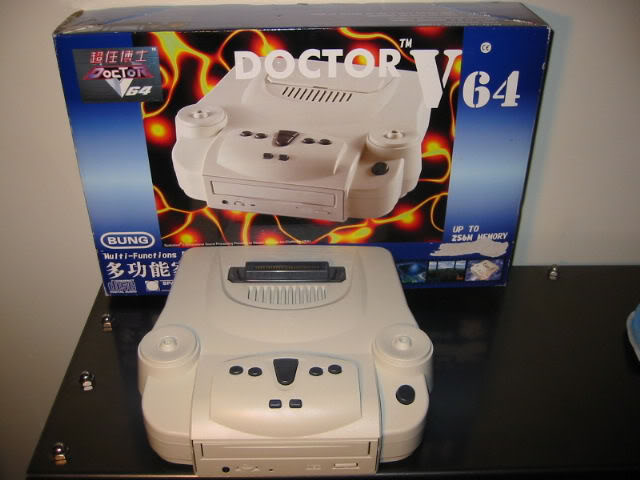

    Hasnt the BUNG DR V64 special development options for stuff like this ?
    It turns every n64 in dev state and can recieve commands over printer port someone can name modern cheap alternatives ?
