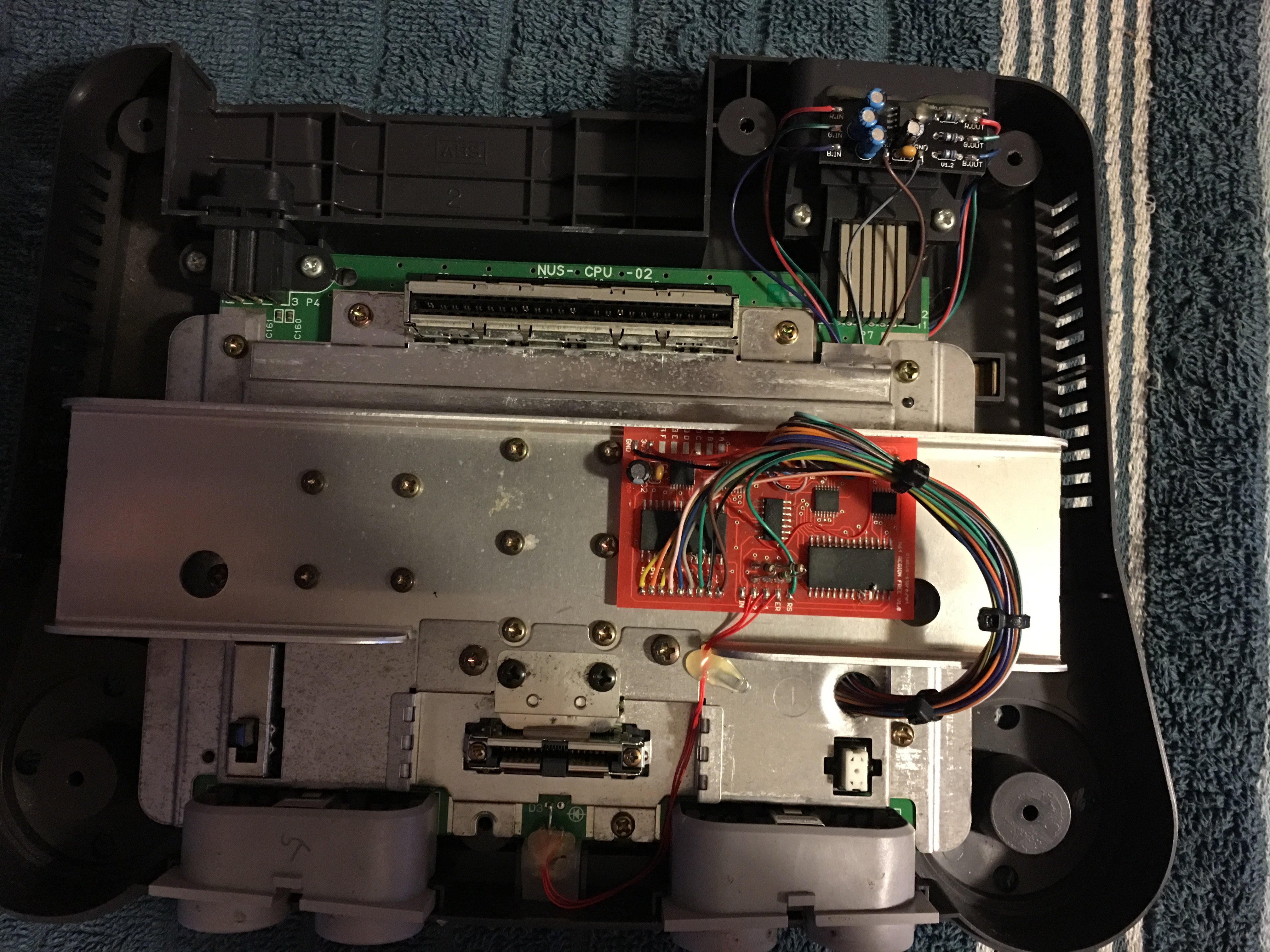

    Sorry about late contribution. I finally opened up my multi region n64 from Otaku and took a pic. Unfortunately i didn't take a pic of where the bunch of wires went to on the bottom of the board.

    Does anyone know whether they are using a specific MOBO for this mod?
    I know from doing the UltraHDMI mod that some signals differ on the PIF chips.
    I’m asking as I want to move this region free mod onto a ‘simple RGB’ MOBO and I’m worried I might send the wrong signals through the mod and blow it up if the PIF pinouts are different.
    Any help appreciated.

    The PIF pinouts are the same; the board design around the PIF location differs slightly.
