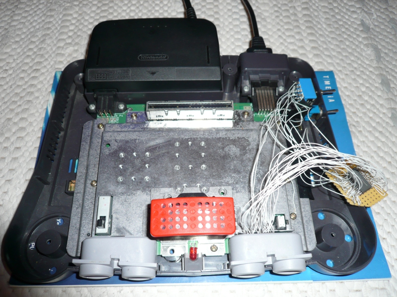

    Aug 5, 2006
    Here's a picture of the inside of my N64. I bought it already modded with the region switch from http://www.otakus-store.com/. They sell a lot of modded consoles and also do a lot of modifications so maybe they know how this mod was done. It works 100% for all games, even PAL Perfect Dark works perfectly.
  11. Ho-Oh.x7
    Ho-Oh.x7 Member
    Aug 25, 2012
    As far as I'm aware the refresh rate is determined by software settings so NTSC games should run at 60 hz. If you load an NTSC game on a PAL console with an Everdrive or other backup device they run at 60hz. Some games will have audio errors because your using the wrong PIF chip.

  13. Bad_Ad84
    1,309
    Region is set via a very complex method that isnt cracked (i.e. a replacement chip, like the supercic). You would need a way to give both types of PIF responses to the console. Which is why people are installing both chips.
    Now you could install both chips, install some solid state switching and then control them via a switchless mod, but its no where near as simple as you are making it sound.
