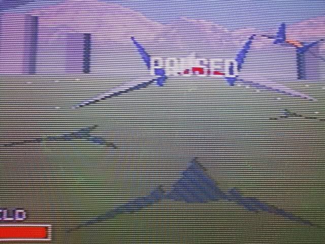

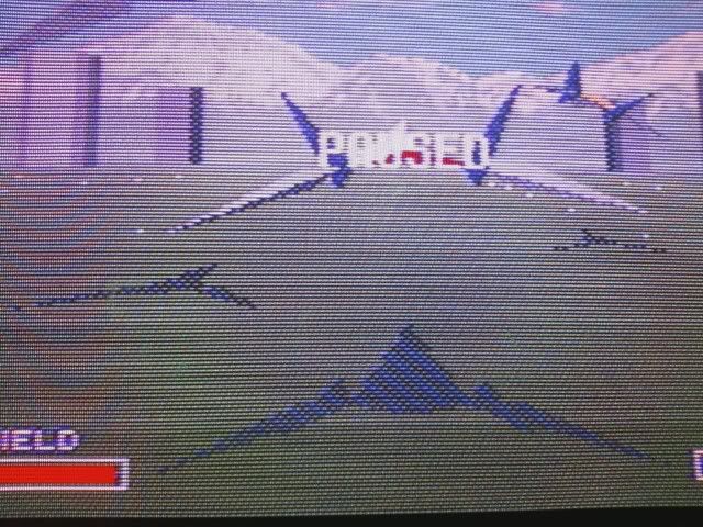

    I just did the StarFox test.
    here,
    composite
    S-video.
    Obviously, it's a different video output. you can see the checkerboard effect on the s-video that can be seen in emulation, and is covered up by composite and RF by the blurring the format causes.
    so...who has SNES2 and wants to plug in a gamecube S-Video cable and squash this urban legend?

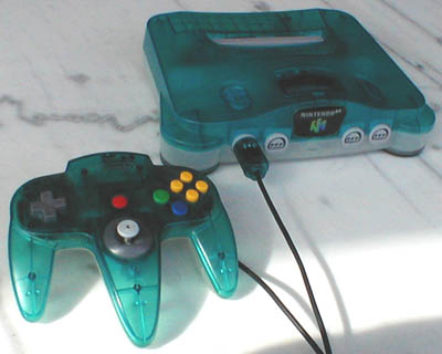

    As link83 already stated you need a special PAL S-Video cable otherwise the colors are too bright. I have both, the PAL and the NTSC S-Video cable. The PAL S-Video cable is thicker than the NTSC cable because of the extra components. So you can easily recognize it.
    btw, according to Wikipedia (German) the Clear Blue model does not support S-Video:
    http://de.wikipedia.org/wiki/Nintendo_64#cite_ref-3
    I think it's this model because it's the latest model released in Germany:
