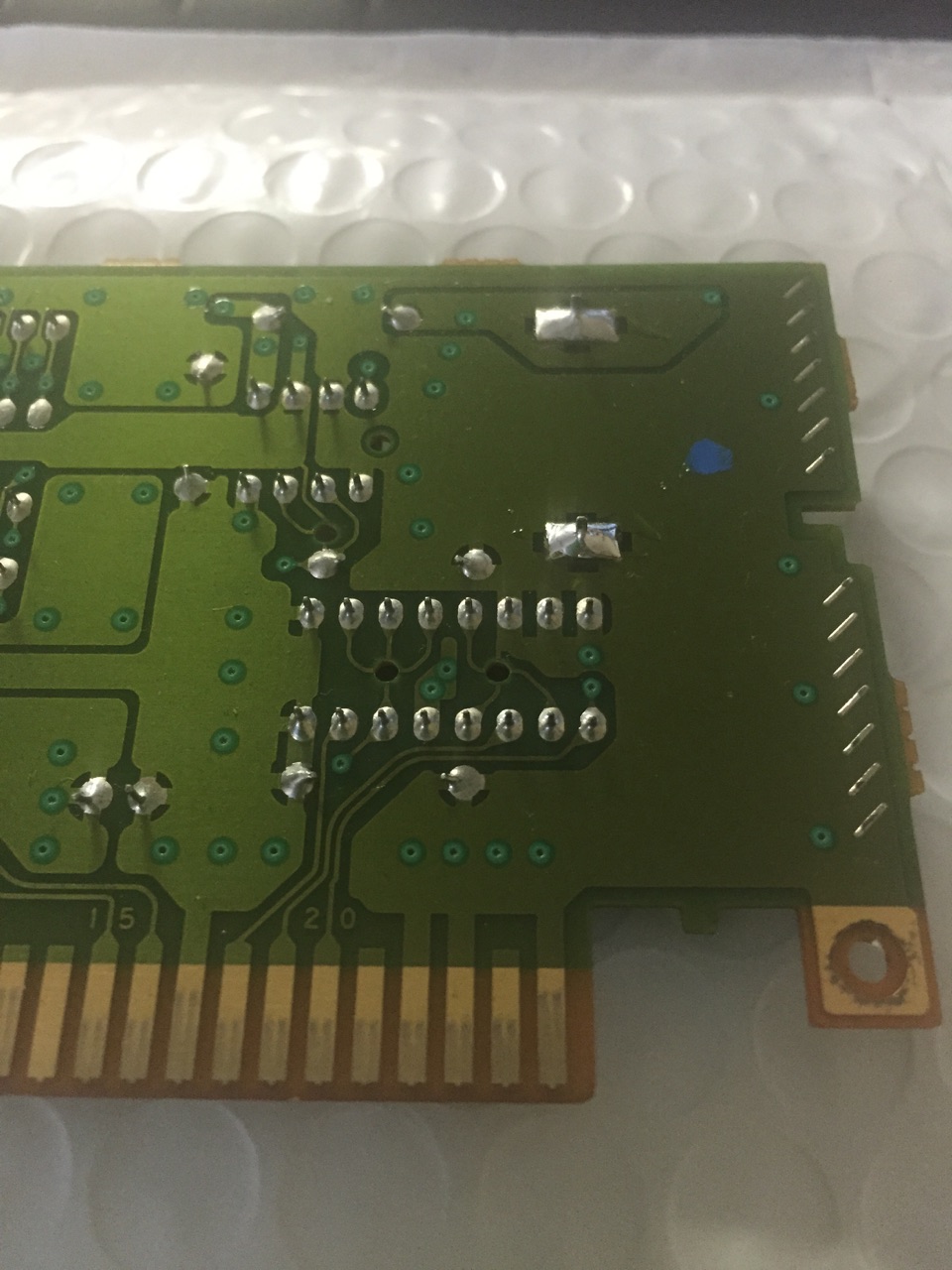

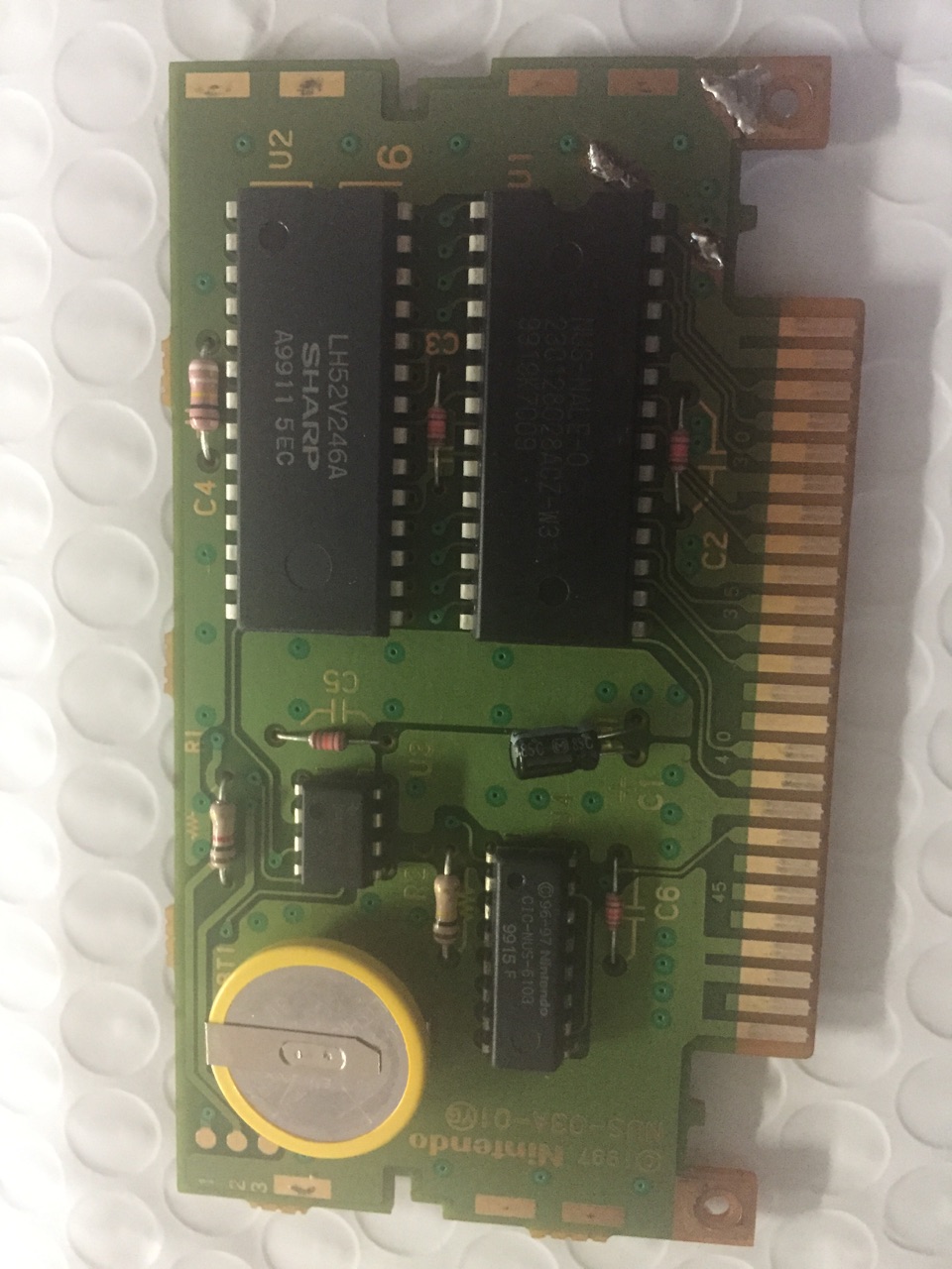

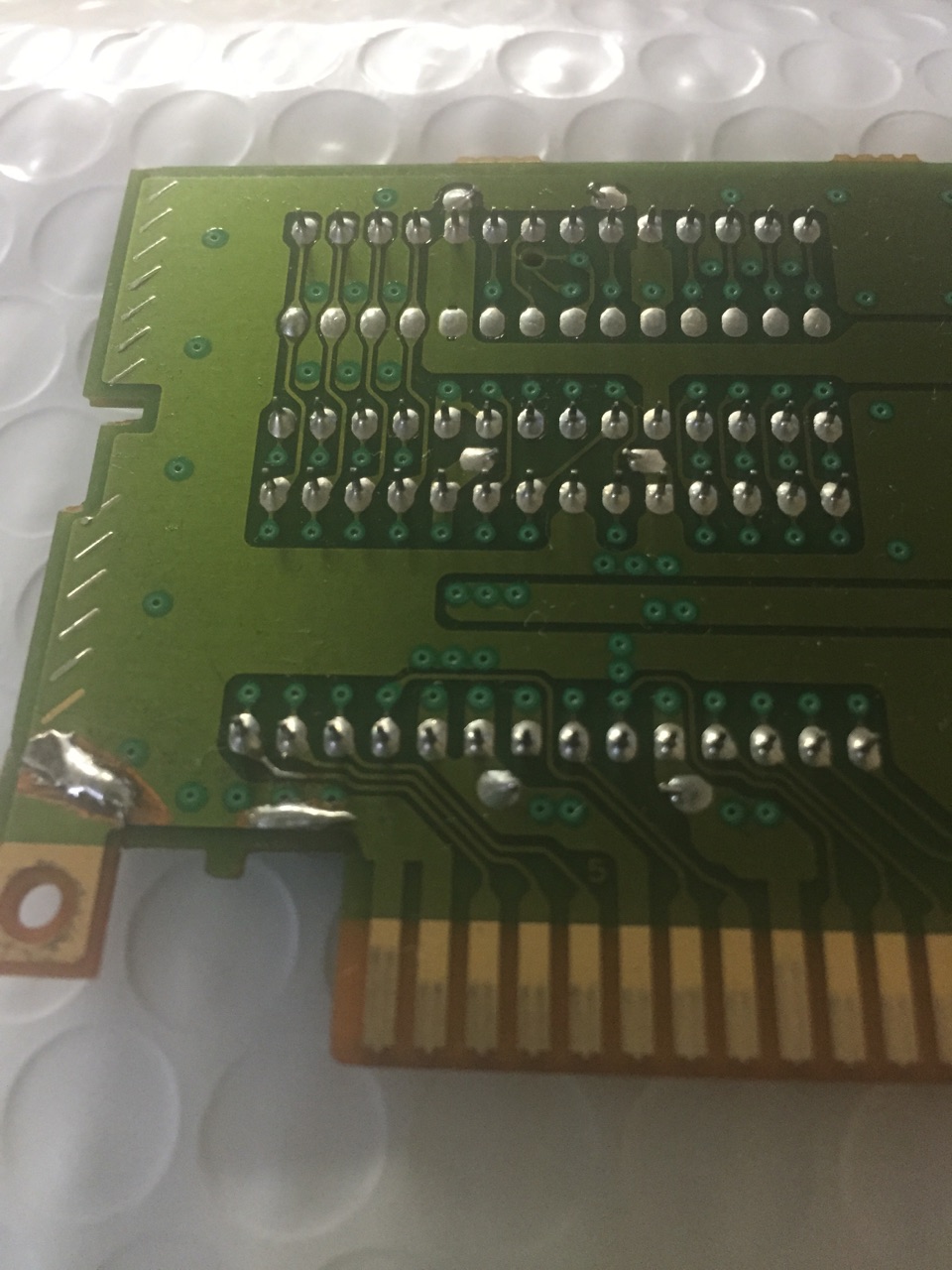

  12. Whide Yacon
    Whide Yacon Member
    Apr 1, 2016
    Hopefully these image are clear enough. To my untrained eye it seems that everything looks good enough.
    I've seen that a lot of people use either 1080 or ken griffey as another game to take the SRAM from. Is one of these better than the other? Or is there a game that's better to use other than these two? A friend of mine is good at doing this type of stuff so he should be able to swap it no problem.
    Thanks for all the responses!
  13. takeshi385
    Mar 29, 2011
    1,856
    164
    Why are you patching ground plane? Dude, not to seem harsh but you might be in over your head. You have a very high chance of destroying the traces on the sram if you try to remove it without proper equipment. (like 80 percent chance of failure) @APE You might want to chime in with tips.
  14. Whide Yacon
    Whide Yacon Member
    Apr 1, 2016
    By patching the ground plane do you mean the solder that's in the bottom corner next to the ROM? I just bought this game on ebay and that was already there.
    I'm definitely in over my head :D. My friend works on circuit boards all the time though so he should be able to handle it. Since it doesn't save data I'm looking at it in a way that if the SRAM traces get destroyed then I'm breaking an already broken game. Smash Bros without Captain Falcon unlocked just ain't right.
  15. takeshi385
    Mar 29, 2011
    1,856
    164
    Oh I got nervous when I saw that the ground plane was being patched. The ground is connected In many places so its generally doesn't need a patch. Hopefully your friend has a desoldering iron, because speaking from experience braid and flux is a pain. Also much of Nintendo's boards use a solder with a high melting point. Best of luck getting it repaired.
