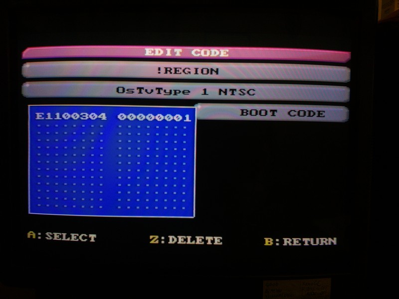

    It seems the code for a PP3 is different than for an AR/GS. This one should work.
    E1100304 0000000X
    Change the last digit according to the region you want to spoof in. That is, match the code to the ROM if the ROM doesn't match your console.

    I tested :
    E1100304 00000000 : sound problem, good music speed (60hz)
    E1100304 00000001 : NO sound problem but music speed slow (50hz ?)
    E1100304 00000002 : NO sound problem but music speed slow (50hz ?)
    Not tested in game for the moment, i'll test tomorrow.

    It works for me. Did you use the bubble on the right and set it to "BOOT CODE"?
    Be careful: If you type the code in and then change to "BOOT CODE" the code will change too, so make sure you re-type it.

    Yes, i use Boot Code, sure.
    The music is more slow with code but the game action is normal (60 hz).
    Look the video capture without and with code.
    The music is "slow" with code and more speed without code but Mario hit the walll at 12'03 with or with code.
