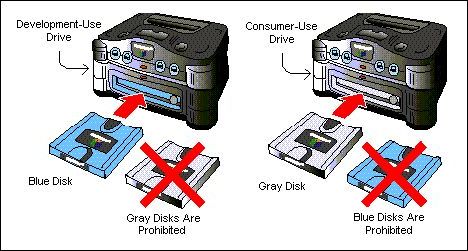

    Something I forgot to mention. Comercial DD units can not boot dev (blue) DD Disk and Dev DD units cant boot Comercial (grey) DD Disk. So there is a need for the comercial IPL to be dumped.

    subbie, from what I recall the drive it self is part of the barrier in running dev disks on commercial units and vice versa. Look inside the manual, you know it be true. Is the ipl part of the problem too? (PI i guess)

    In the interest of fellow 64DD coders and curious folk ;)
    What's wrong with this picture? ;)
