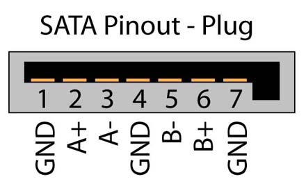

    I wanted to take a 25 pin SPI and solder the power and SATA cables to it, so I only need to attach one plug to the external DVD case.
    That´s what i did, BUT it gave me an E65.
    after thinking about I decided that i should try a thicker cable for the ground (I made all 3 ground from the SATA Plug into one ground)
    after this i do get an E64...
    anyone got an Idea?
    I used cables with a 0.2 mm diameter for all cables beside the ground from the SATA cable and the cables are around 25-30 cm/ 1 ft long and I ran out of ideas....
    any suggestions for how to fix the E64 Problem are welcome
    I guess i will get me a new SATA cable and try if the Drive works if i connect the SATA as usual and just connect the power cable with the SPI

  2. ASSEMbler
    Grounds are separate for a reason on the sata cable.

    well...recording to this topic : http://forums.xbox-scene.com/index.php?showtopic=719557
    it should work....
    whatever i´ve just bought a new SATA Cable and if i connect the SATA on the usual way and only the power with the SPI then I sometimes get it working...and mostly it shows the "no DVD Drive connected" blinking Power LED
    what im going to try later is just using thicker cables for the power....i hope that will work -.-
