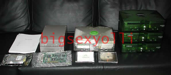

    I also have a fully working Debug and a Devkit, as well as a Raptor PCI DVD Emu card and a HDD + 2 SCSI-burners. If anyone can tell me how to setup a Dev-environment with all the things, that would be great. A tutorial of some kind (even from the XDK, yes I have it, see pics) would be great, too.

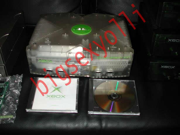

    Have you tried using the recovery disc,it should fix your problem.

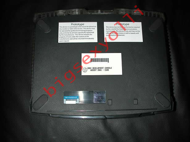

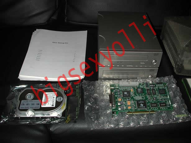

    The one in picture 5 is a DVT-3. What is the date on the recovery disc? If you run ANY recovery disc aside from 3823 you'll ruin the system.

    the two silverish drives in the picture look identical with the Dolphin's NR writers. Is this really the case? If yes, does the XBOX and the Dolphin share the same kind of writer for unpressed discs?

    I'm pretty sure it's a DVT4. I know several ppl who have DVT4's with the prototype stickers on the bottom.

    An august 01 with the proto sticker would most likely be a DVT-3... unless it's a DVT-4 preview, but i think those are labeled as such?
    the easiest way to tell would be if the usb port is covered on the back. Covered == DVT-4. Open == DVT-3.

    To solve the mistery: It`s a DVT-4, the USB-Port is covered. Is that good or bad, consolewise? Any way of getting more info from the console by setting it up in some way?

    And whats up with the SCSI-Burners, are they useful in any way?

    I'd say that the SCSI burners look too similar to GameCube NR disc writers, but I could be wrong ( I haven't seen the XBOX beta burners ). Are you willing to sell one of them?

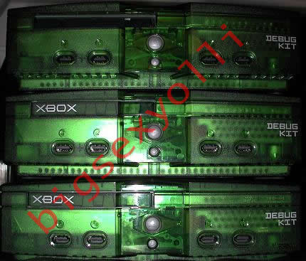

    I have 3 ways to dev for the Xbox now(hope I got the numbers right):
    1. Debug-kit with 4043
    2. Debug-Kit with 5933
    3. A Development-Kit with 58xx, I think
    Whats best to program games with? Collection-wise is no. 3 the best, I know that much, but deving-wise, what would you suggest to keep?
    One more question about the HDD that comes with the Dev Kit: What is that for and what could be on it? I dont get the purpose of it yet. Or must the Raptor card be hooked up and installed to access it. If I hook it up as a salve device on my PC it shows up in my hardware settings, but its not displayed in the explorer, so no access that way. Or might it be just blank or so?

    If you are going to be doing actual programming, use the Devkit. If you will be emulating. Othereise a debug would work fine. The biggest difference between the 2 is that a dev kit will allow you to emulate games. Hence the Raptor EMulator card you have. The purpose of the Hd that comes with this setup, is that it hook sup to the Raptor Emulator card, and devs use it to emulate the games they are developing rather than burn a new disk each time they try something. basicly what it does if when you choose to emulate a game through the Xbox Game Disk Tool, it will build a special version of the game on that hd rather than the system you are using to develop. What it does is run the game exactly like it would off a DVD in the Xbox so it can test things like file layout, and loading times. The hd is meant to be a dedicated hd for the Dev kit emulation, ut can be used for anytihng. Now what you are supposed to do when installing it, is one you have the card installed with the driver, you are supposed to format the HD. If you want to see what is on it though first, I would say either hook it up as a slave drive in your comp, or just right up to teh Raptor one you get it installed correctly, then use a data recovery tool to access its content (Pm me and I can point you in the right direction on these) Once you are satisfied with what you, copy what you want to keep off it (If anythign is there) then re-foormat the Hd so you can use it, and you should be good to go. I hope this is helpful.
