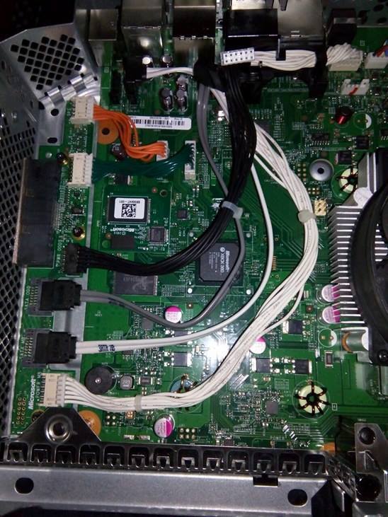

    It's a trinity dev kit with sidecar female connector.

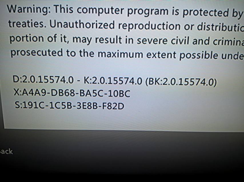

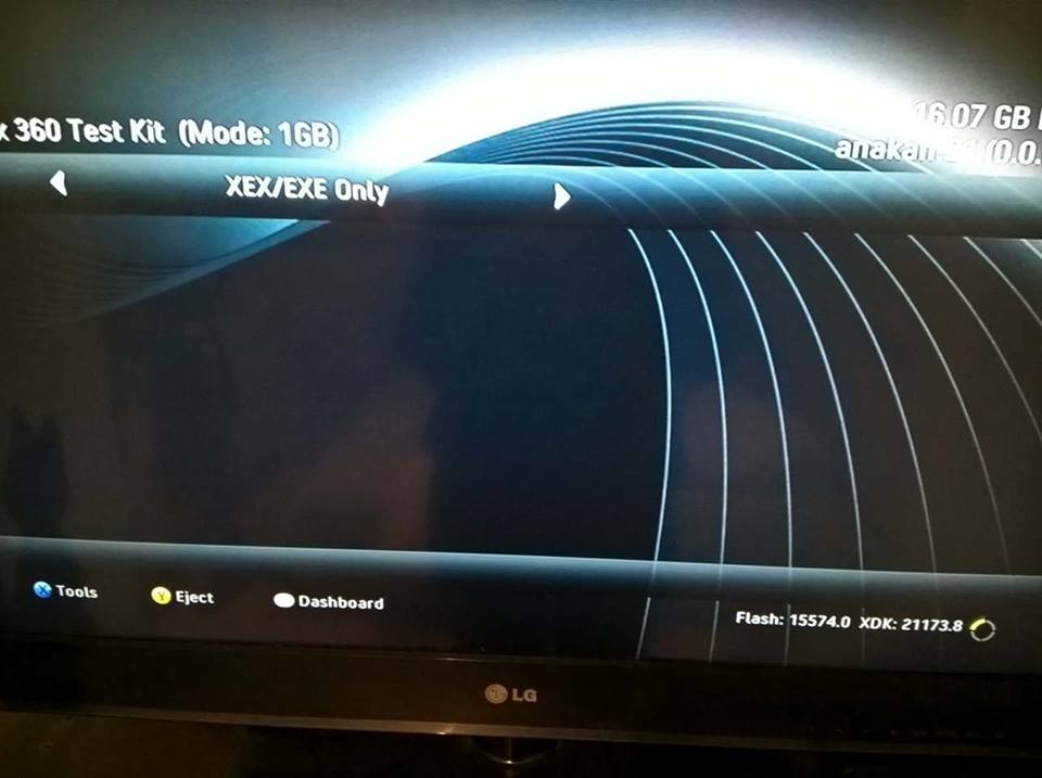

    I patched extracted iso whit x360gamehack and some games work but gta 5 and rise wont work i didnt try whit GOD,here is some more photos

  12. ddxcb
    ddxcb Gota J.T.A.G. That Xbone Yo.
    Apr 17, 2008
    388
    Also looked at the xex, needed kernel 16202 or higher, which the guy is at a lower one than that.
  13. MrMario2011
    MrMario2011 Robust Member
    Apr 8, 2016
    298
    137
    Yep, 15574 is quite an old dashboard. If RotTR is dev signed it probably needs a newer recovery to boot.
