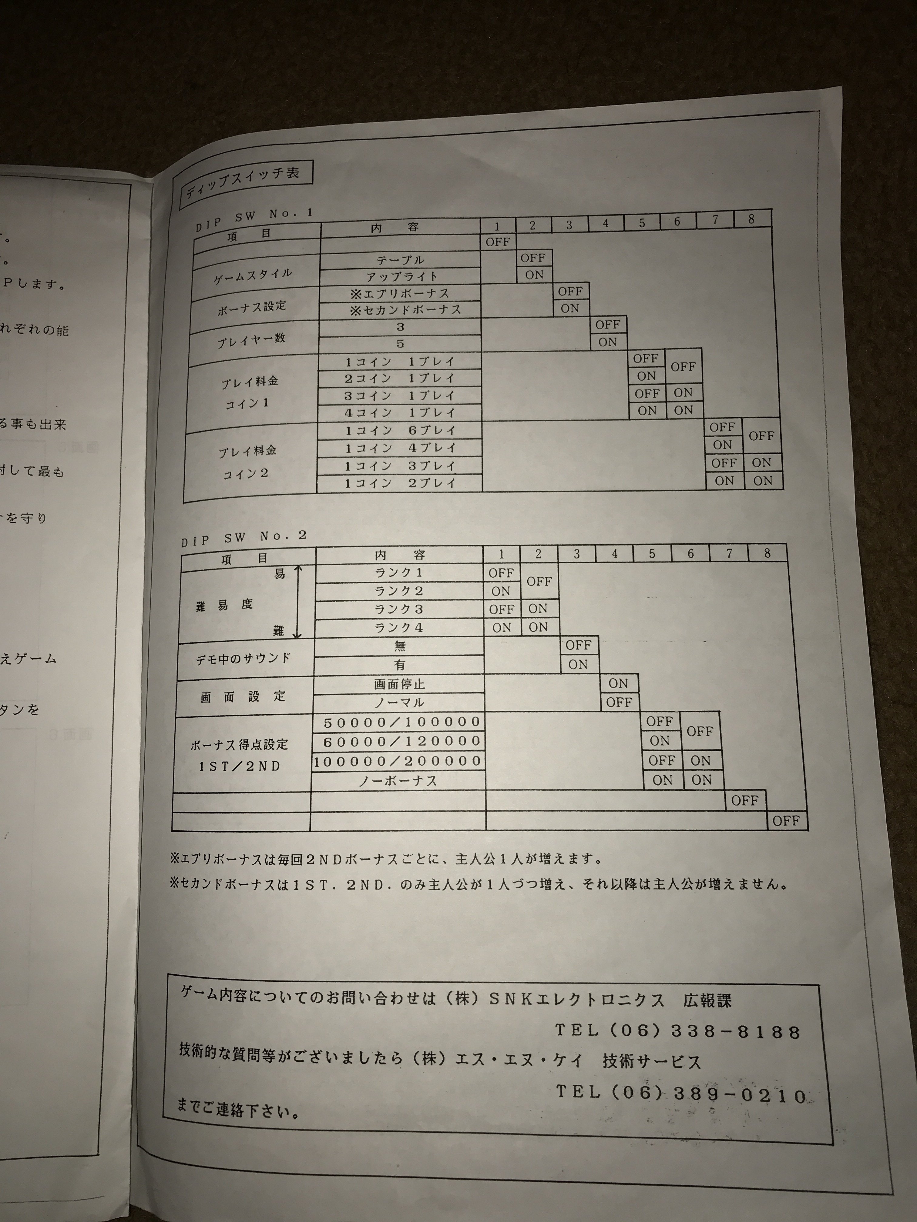

    i setup my supergun today with a arcade psu 16A on +5V and 1A +12V and gnd of corse. My arcade board is Athena from SNK (original). Startimg up my supergun, used the poti to ajust +5V. And i got a picture , so far so good.
    My picture is flipped 180 and i have no sound.
    I have the instruction sheet but its in japanese..
    My questions now:
    How can i flip the picture? I know there is an option from the arcade board to do this.

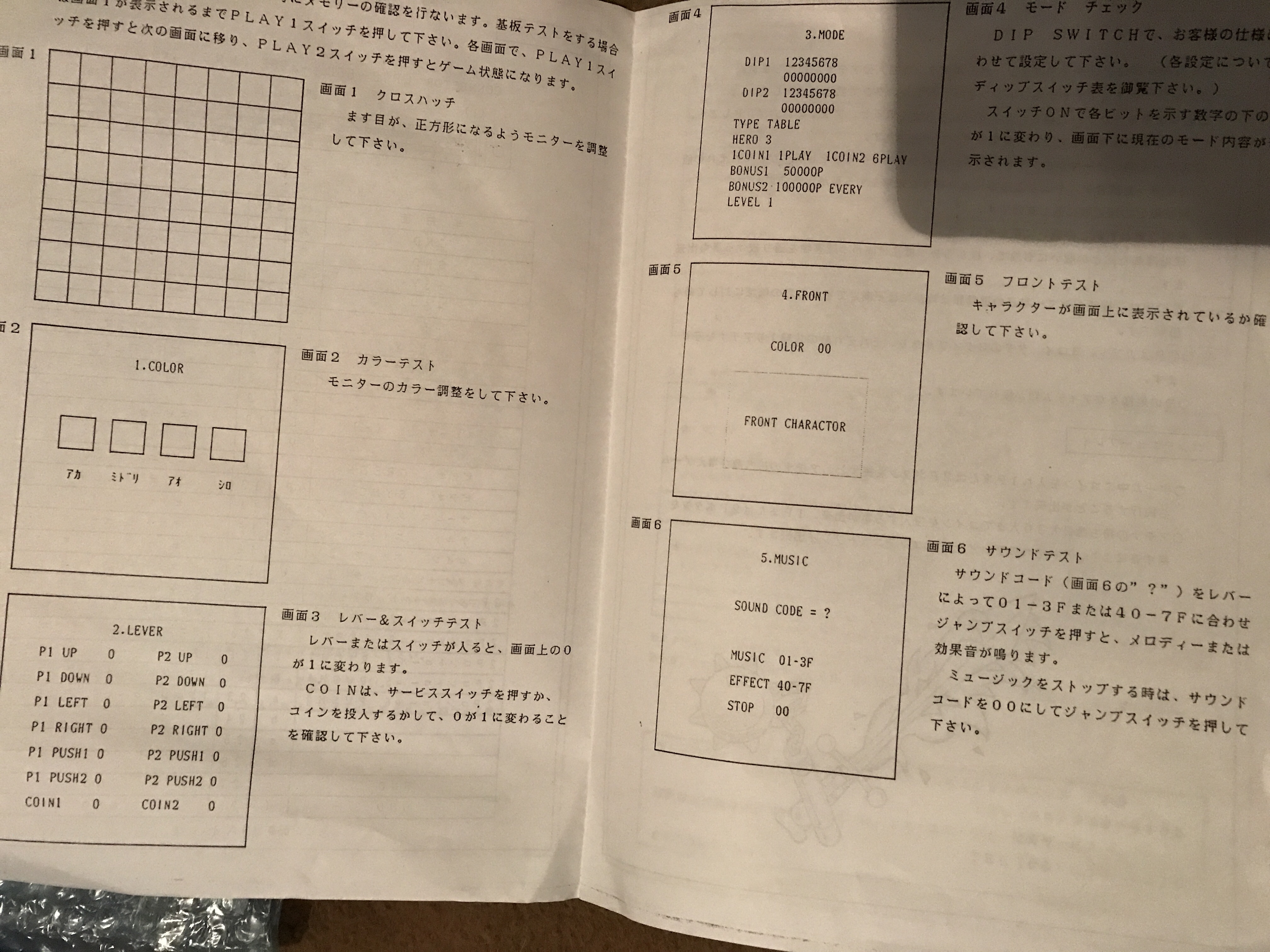

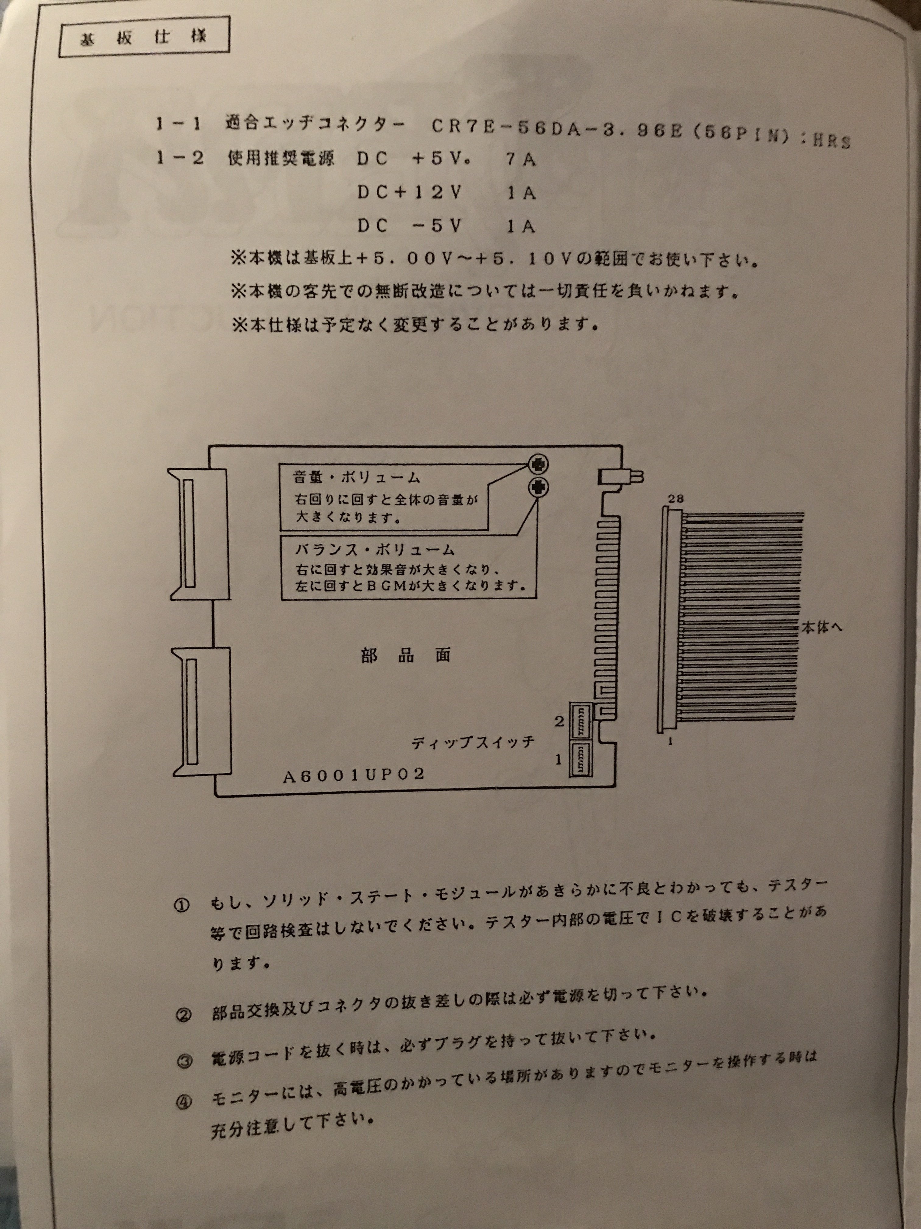

    Do i need the -5V ? And what sound code i have to select on service mode?

    On bank 1 set dip switch #2 to "ON". That will switch the cabinet type from "table" to "upright". See here for reference: http://www.crazykong.com/dips/Athena.txt
    I can't help with the sound issue but what you're referring to in the service menu is just a sound test. The codes stand for in-game sound/music.

    Ooh! I don't think there is a scan of the Athena manual!
    The Yamaha FM chips and Z80 don't need -5V. Is there a volume pot? Maybe it was on an external bracket in the coin door? Or sometimes via the service menu.
    That said, some sound circuits needed -5V. If you have -5V on your PSU (most arcade PSUs should), connect it. It is well worth having the right PSU anyway, if you're going to be swapping boards.
