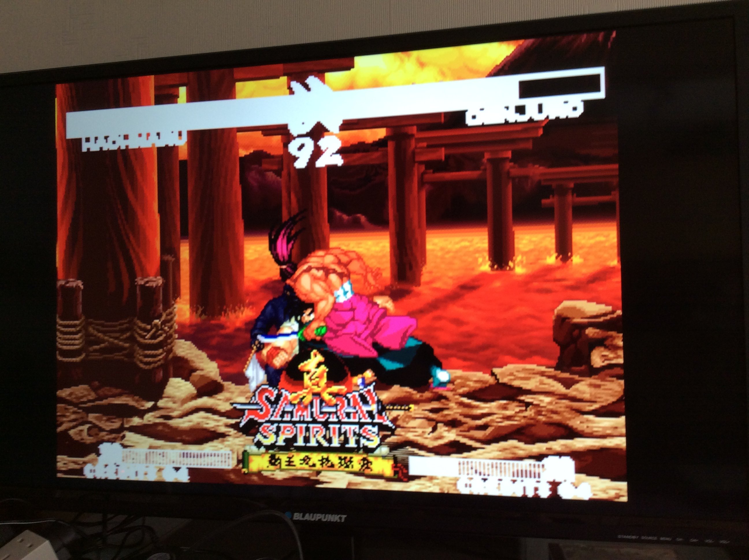

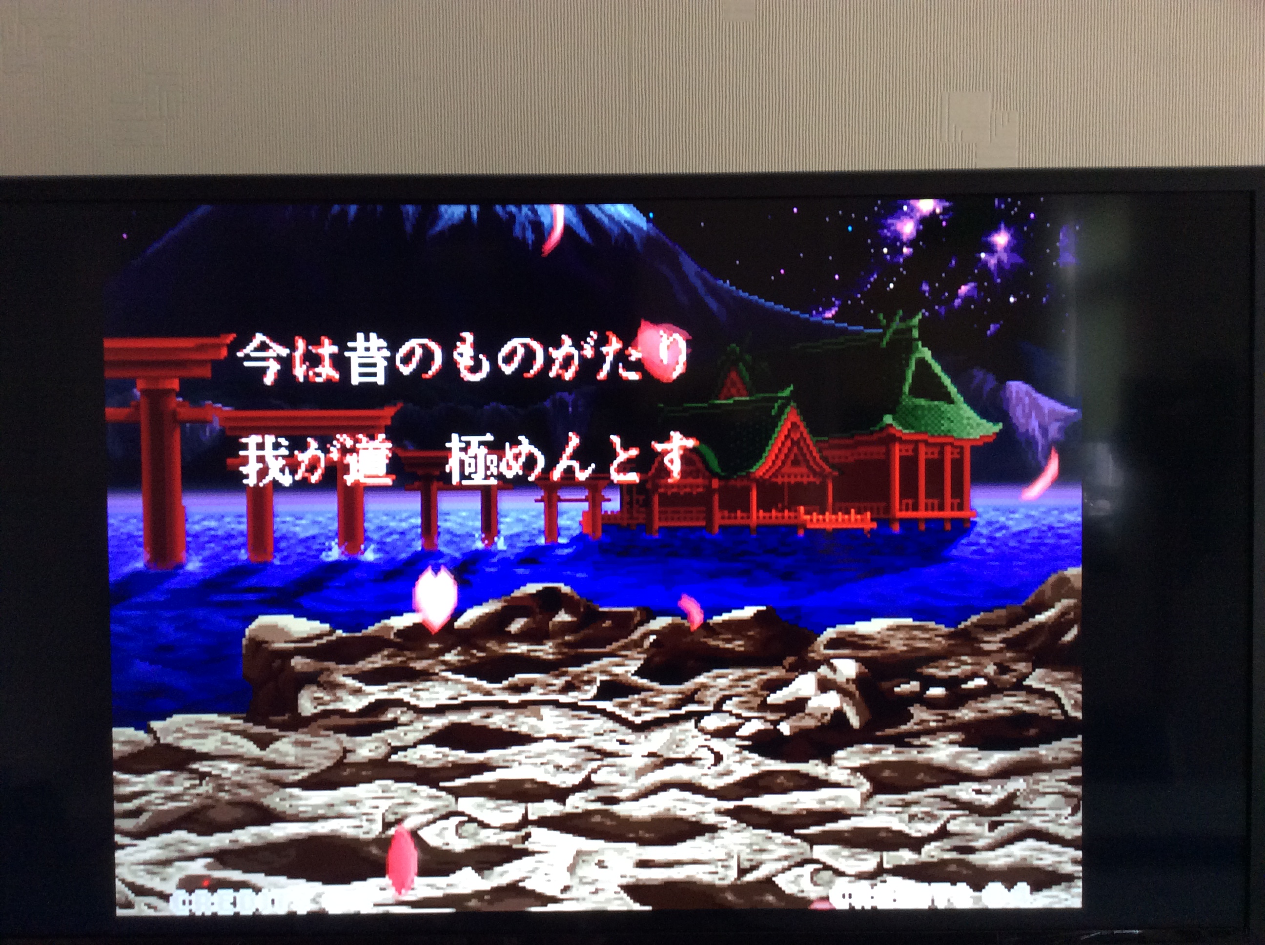

    After cleaning contacts and the board in general it is now working. However I have some odd issues with Samuri Spirits 2, see pictures below. I have some issues with overly bright parts of the output. For example the region message should have a black background, the insert coin and energy bars in game are completely white. Very strange. I will try this special bios, however I don't have a controller yet so I won't be able to choose any options.
