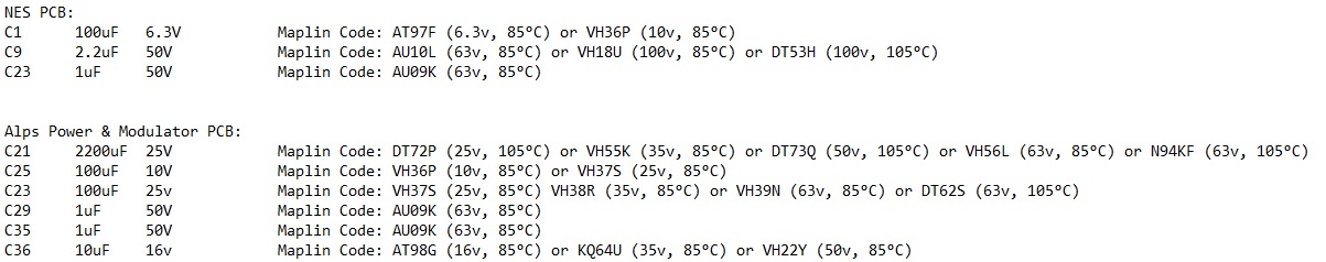

    Where can i get a cap replacement kit form for a NES frontloader for UK delivery, i know console5.com sell them but dont appear to ship to the UK. Either that or if someone knows the list of cap types require and maybe i could just order them separately?

    Ok using Maplin (a well know electrical distributer in the UK) i have found the following for anyone else wanting to know the codes..........
    I have found some alternatives that are slightly more voltage and some even have higher temp ratings, is it ok to use caps that are of higher rating than what is stated in the Console5 wiki page, im guessing you dont want to do to far above the rating as the size of the cap may increase, is this correct?? (the 1uF caps i couldnt find 50v rated versions so had to select the 63v)

    correct, bigger voltage/temperature ratings are perfectly fine - just don't go too far since the size of the capacitor will also change.
    Those that you have on your Maplin's list are perfectly fine and the same size as the original ones.

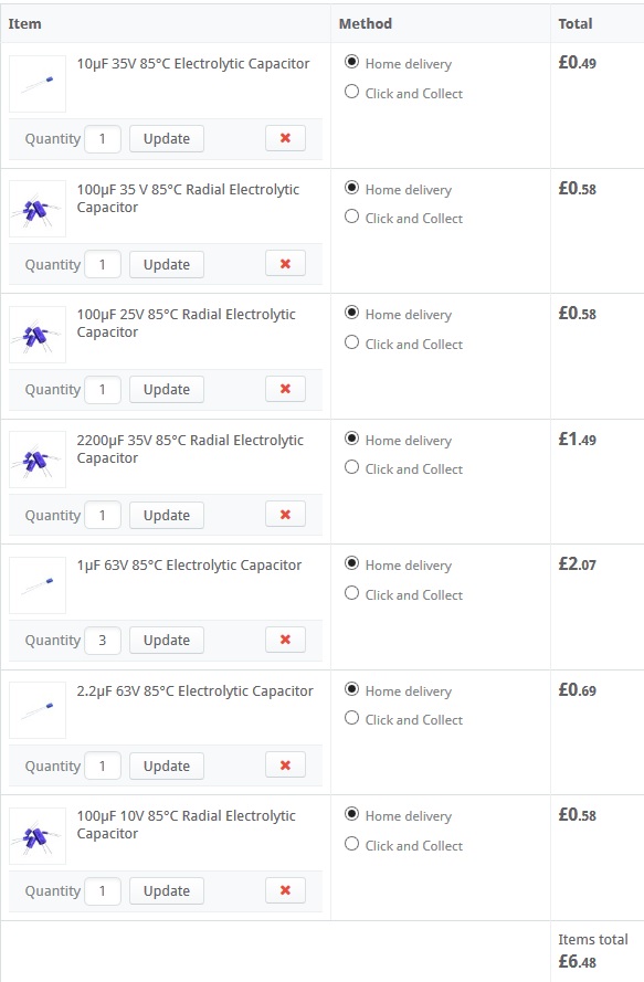

    Thanks. this is my basket then....
    I have gone up one stage in voltage for each cap, hopefully they wont be too big!? Not bad for under £7

    the size is the same or so close that it doesn't matter , the list looks fine and looks just about what I can get locally :)
