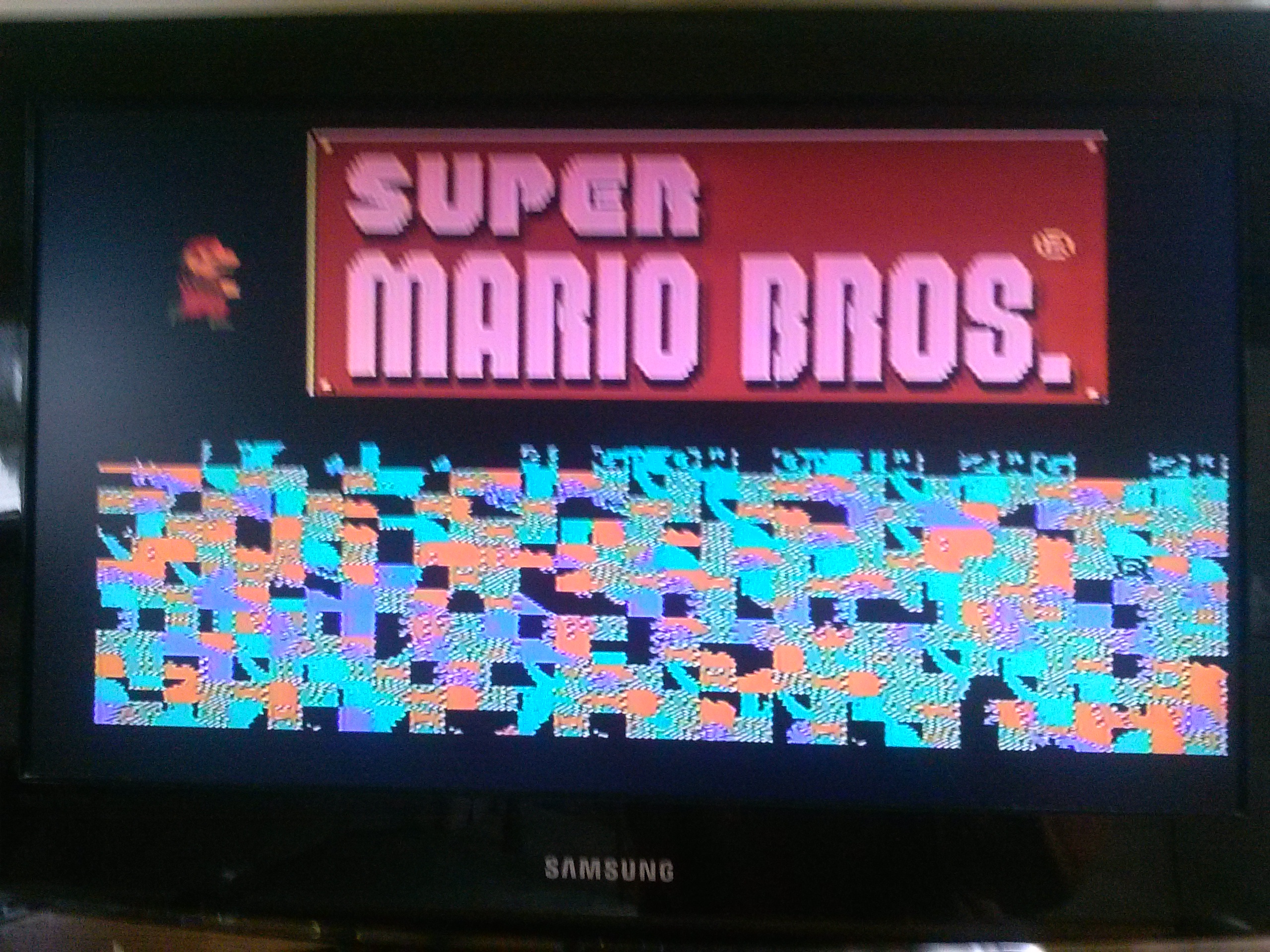

    I'm getting a solid gray screen too. Lockout chip has been disabled, 72 pin connector replaced, games cleaned with brasso and rubbing alcohol, capacitors replaced, voltage regulator replaced. I think it's dead. I tried everything. Any help would be appreciated. It's an NES-CPU-07 board, if that helps at all. I refuse to give up on this one.
  11. Scott G
    Scott G Member
    Feb 14, 2016
    This is what im getting with Mario. When I hit start it freezes.
