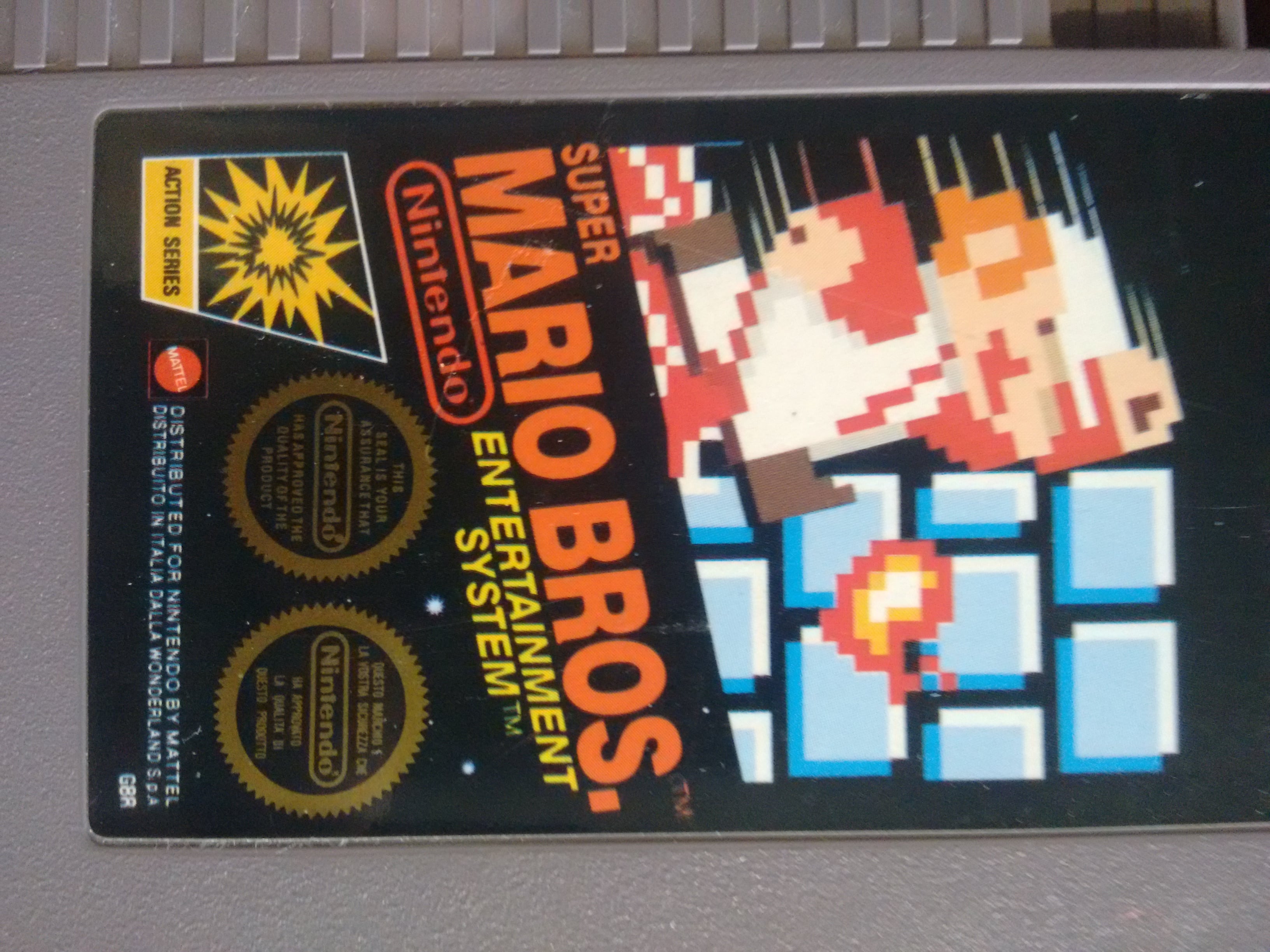

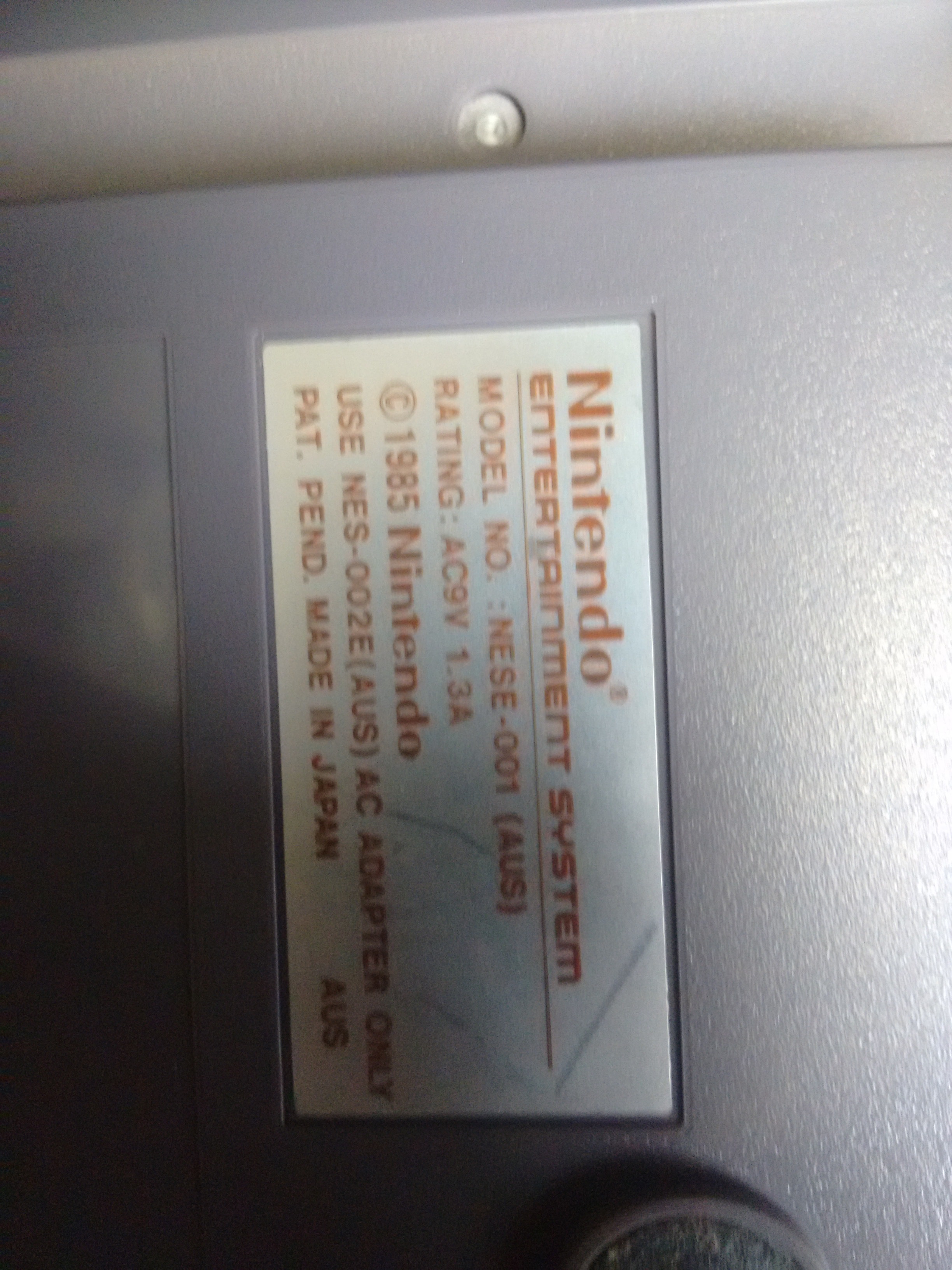

    I've just finished trying to restore a nes I acquired recently from a friend, the unit didnt work which turned out to be the 72 pin connector which I have resolved and thats all said and done. While I was at it I also replaced the a/v and rf connectors on the unit, gave it a thorough clean and then re-assembled. I purchased a copy of super mario bros for testing, thinking I was getting it from a local supplier (I live in Australia btw, Pal region). However from what I've been reading on the internet it looks like my copy is still a Pal version but possibly an Italian version (I'll add a pic below of the label), something tells me this shouldnt be a problem anyways, I have also removed the lockout pin, while I had the unit open.
    Since first booting the console the game runs very slow, Ill add a video of the performance of the unit to demonstrate, while the video might have been captured at 30fps via my tuner card, you can tell that any lag committed by my tuner card or by the recording of the video is far too slow to indicate those issues being a problem here. Both the gameplay and audio are excessively slow and pretty much unplayable. One thing I have tried to resolve is mabey it being an overheating issue but the only component i can see that gets pretty hot is a mosphet that is mounted on the outside of the rf unit, which I have re-applied thermal paste (artic silver) but that does not seem to have made any difference. My thoughts are now moving towards could it be a cpu / memory issue? how can I tell if it is? or hopefully the video is enough for someone to be able to diagnose the fault, see what happens!
    Thanks in advance for any help ladies and gents i appreciate it :D.
    Video of performance..
    Images are of the label with the game I am testing, I don't currently own any other games at the moment, the other picture is a snap of the label from the console, just incase this is a region issue.

  2. Braintrash
    Braintrash Peppy Member
    Nov 5, 2011
    303
    Test with another game, but not a European Mattel one. Those were slower. It's the game, not the console.

  5. ESM
    ESM Famicom Disk System
    Jan 1, 2016
    123
    62
    The Mattel version isn't actually slow.
    They made two versions, one for Europe and one for AU. Europe was PAL-A And Australia was PAL-B.
    The AU one was just as fast as the NTSC version except the music was sped up.
    As for the European one it was just 10% slower and I am almost certain it was not as slow as that video you had there.
    It's probably the game, I would suggest trying a different game or buying another copy of Super Mario Bros.
  6. ramiq27
    ramiq27 Spirited Member
    Dec 11, 2015
    101
    41
    It's definitely the game.
    I remember a while back I was restoring some NES consoles and one of them was an Asian PAL. When I inserted an NTSC Super Mario Bros the game play was about 15% to 20% faster. It was very noticeable in the music.
    As mentioned above, consoles from different regions run at different speeds. This is most likely your problem.
