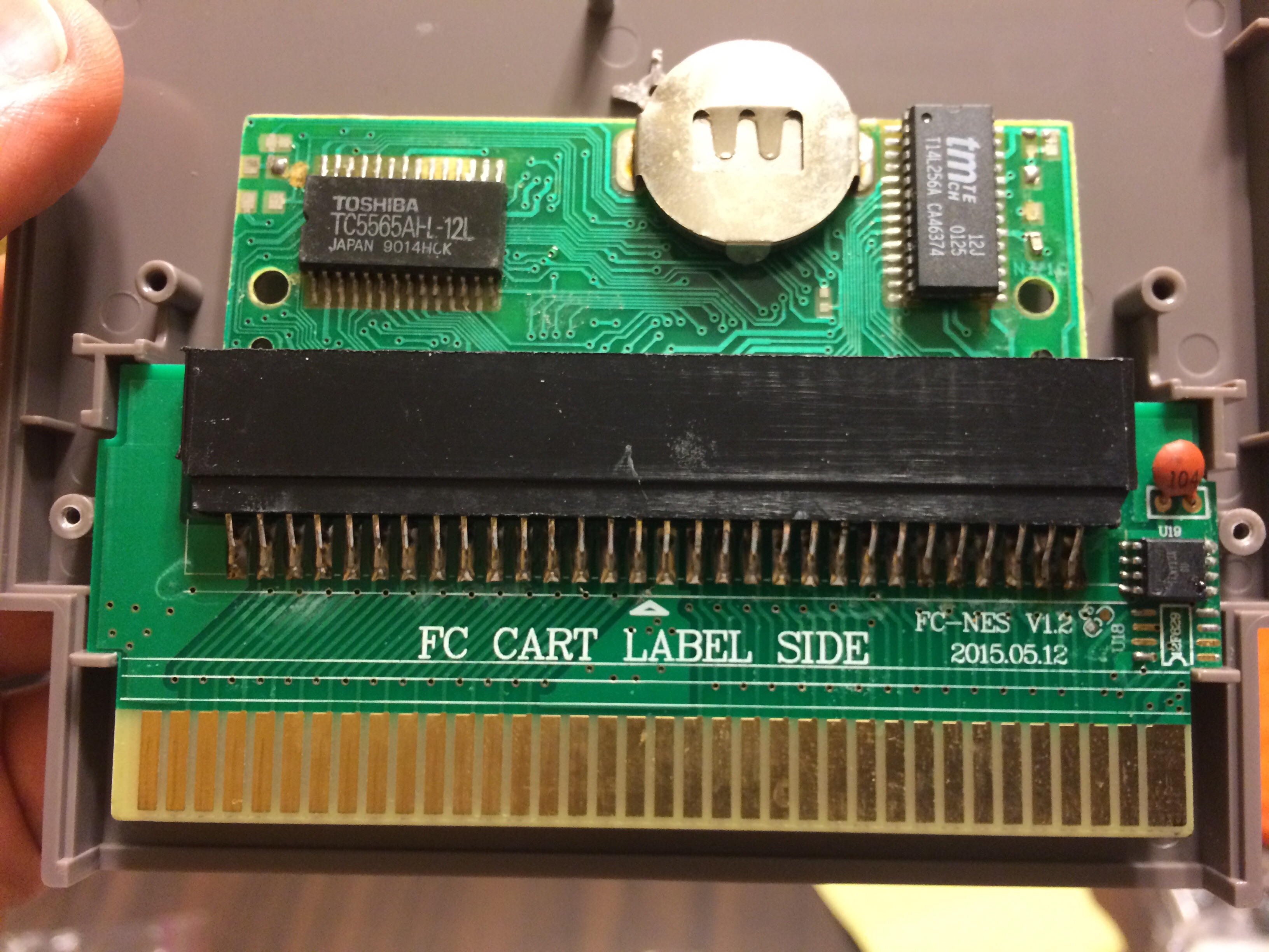

  11. LeHaM
    LeHaM Site Soldier
    May 5, 2013
    2,634
    292
    open the repo cart and post a pic

  13. soulsaturn
    soulsaturn Member
    Jul 19, 2016
    Sorry for the delay. I've tried attaching the photo from my phone, hopefully it appears here correctly.
  14. l_oliveira
    l_oliveira Officer at Arms
    Nov 24, 2007
    3,879
    245
    It doesn't seem to be using a stun circuit. That looks like a CIClone or AVRCIC.
  15. soulsaturn
    soulsaturn Member
    Jul 19, 2016
    Ok. Thank you for the input! So it appears safe to continue playing then (in functional NESs)?
