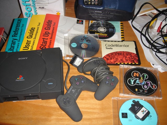

    3 manuals are part of the package, see them below:
    The codewarrior tools were sold separately, as well as a special version of lightwave, but only available in Japan, unless someone prove me wong...
