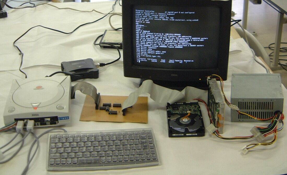

    That is pretty awesome. I remember seeing the old pictures of NetBSD running on Dreamcast with the IDE HDD hooked up to them back in the day. This was way before anybody did anything with the G1 Bus though.

    finally found my micro sdcard breakout board. today I plan on installing the scimci mod for use with the NetBSD setup. also I'm about 15-20% done with my G2 expansion board, its to the point were I'm either guna go ahead and build the ISA slot based g2 board. based off the oldschool netbsd g2 bus schematics. would be nice to use Ethernet on it with the NE2000 isa cards.
