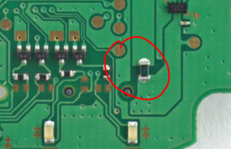

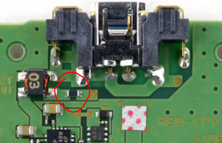

    It sounds like you already found them but are these the fuses you are testing? Those should be the only ones. DB Fuse.PNG MB Fuse.PNG

    Yes, these are the one i found. And they are good. I was hopping to be another one.
