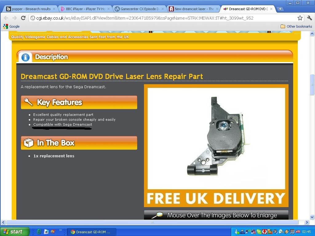

    Ok so I bought a replacement laser for one of my dreamcasts on ebay, seemed legit in the description
    (http://cgi.ebay.co.uk/ws/eBayISAPI.dll?ViewItem&item=230647185979&ssPageName=STRK:MEWAX:IT) if you wanna take a look
    Thing is I installed it and the like but for the life of me I can't get it to read retail games, after fiddling with the pots i can make it read CD-R games perfectly but not retail ones. The game disc spins like it should be reading it but then just goes to the home screen.
    What dya recon is the problem, is the laser thing just a useless piece of junk or is there something I've forgotten?

    As the listing says ''compatible with SEGA Dreamcast'' and not specifically for Dreamcast maybe the problem lies there? Any laser will pick up a CDI game, but is there something in a GD that only a DC specific laser can read or boot?

    What are you talking about?! It says it's a replacement for a Dreamcast lens. It also says it's a GD-ROM lens. (of course, it also says DVD lol)

    Like I said, it says ''compatible with''. Just because it can be made to fit doesn't necessarily mean that that was what it was originally designed for, does it? I don't know, I'm no expert, I was just offering up a possible theory.

    It obviously is electrically compatible with DC as it works to read CD-R. However it may be optically incompatible with GD-ROMs. In the latter case I'd call the description misleading.

    Now look at the rest of it. It says, RIGHT ABOVE THE PART YOU UNDERLINED, "A replacement lens for the Sega Dreamcast."
    Now, what do you interpret that as? A replacement part is a replacement part. You don't buy a replacement engine for a Ford Fiesta, only to be told "but it won't go in reverse". That's not a REPLACEMENT! It's an ALTERNATIVE.
    In my mind, compatible with Sega Dreamcast means compatible with Sega Dreamcast AND SEGA DREAMCAST ONLY - as opposed to, say, a laptop part that's compatible with Compaq G100, G200, G300.....
    The other thing you're missing is that it says GD-ROM in the title. How many CD-i consoles have you seen with a GD-ROM?! Or Blu ray players. Or DVD players. Or Gamecubes. Or PlayStations.... I think you get my point. The GD-ROM is a SEGA product, found only in SEGA products.
    Admittedly, the use of the word DVD is strange - but I think that's the forgivable error, rather than "compatible with Dreamcast" meaning it's only a CD-ROM lens (which it clearly isn't if it says GD-ROM). You're reading too much into it.

    Calm down guys, it's only a misleading description. The lens seems to be compatible with the "GD-ROM reading apparatus" (gdrom daughterboard) of the sega dreamcast, not with "optical GD-Roms" themselves. It might simply be the same type (electrically speaking) of lens, so it's "socket-compatible" with a DC laser assembly.
    Also, just as most toasts are "toaster-compatible" doesn't mean they won't fit in a oven. This lens is said to work in a DC, and does so. Except the HUGE difference, compared to an original Dreamcast lens, that it seems not to be compatible with GD-Rom optical discs.
    About replacement parts, this is open to interpretation, a lot I mean, a whole lot.
    It might very well be a lens that also is compatible with dvd drives.
    It this is the case, the seller should make it obvious in the description as it's clearly misleading.
