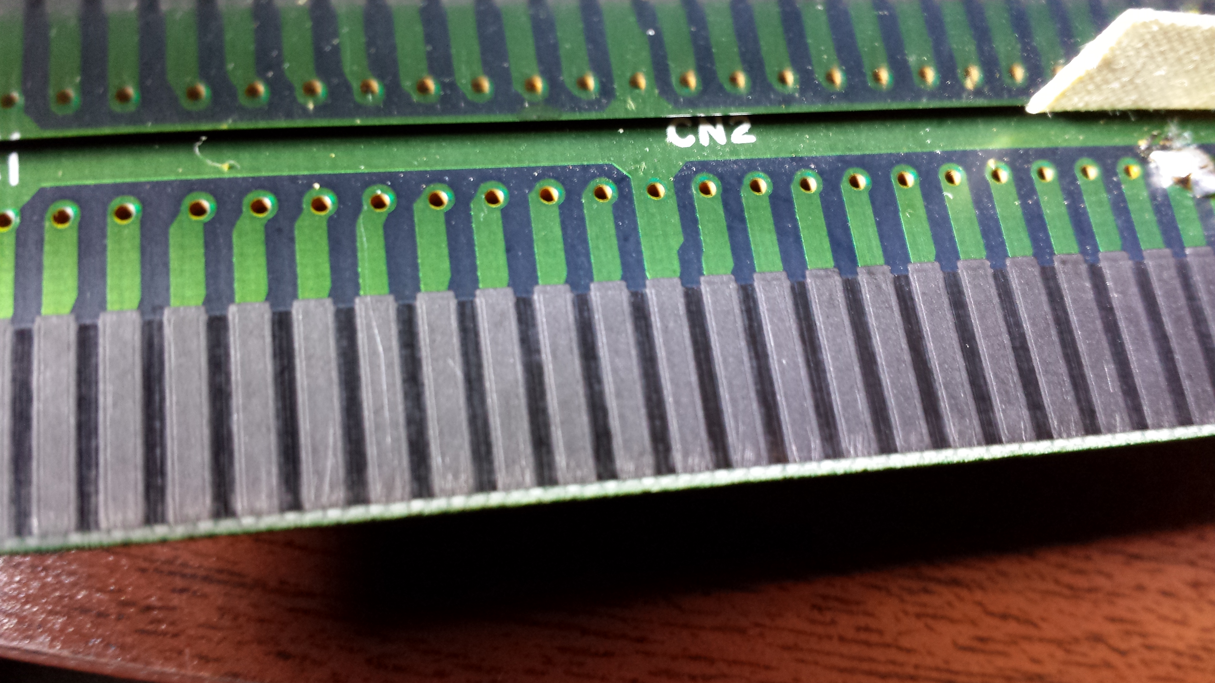

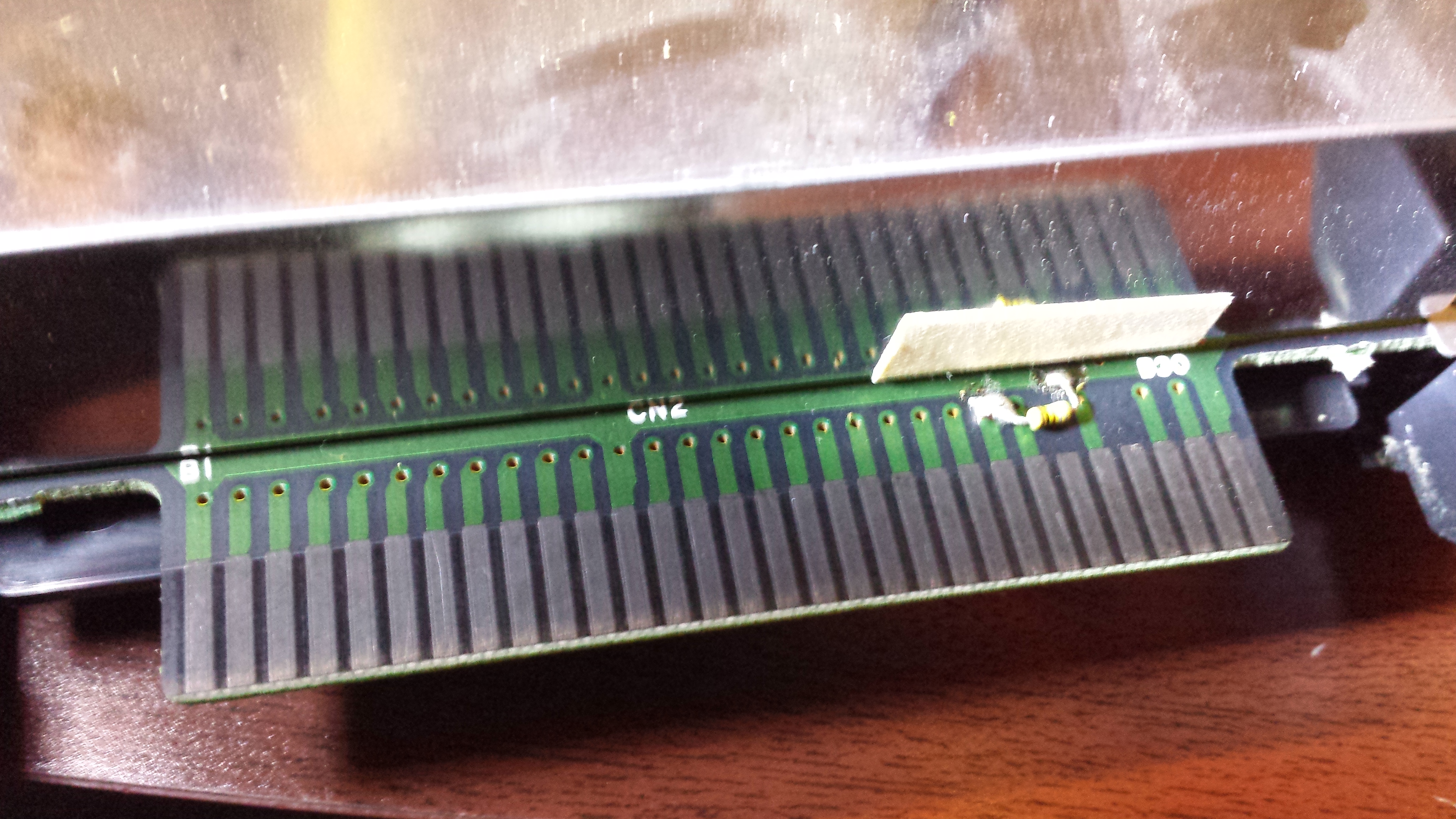

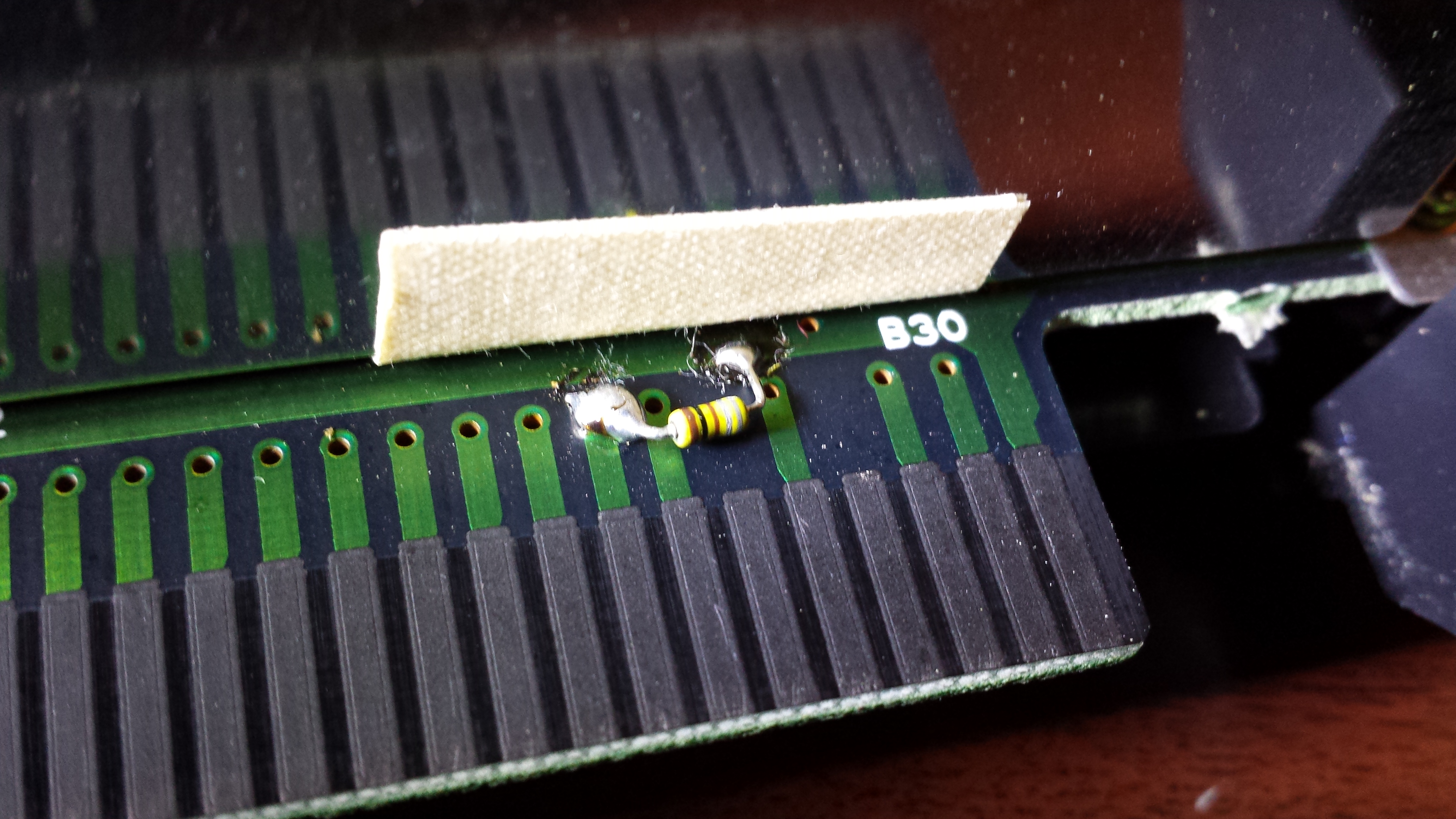

    hey guys, i just got a new model 1 non tmss from ebay and it has some weird things about it. when i removed the expansion port cover it immediately looked strange, the contacts are not gold/bronze but grey! and it looks like someone soldered a transistor or something right on the expansion port as well! also all the screws that hold the system together on the back and inside are bronze colored instead of black! heres some pics: 20160818_183234.jpg 20160818_183247.jpg 20160818_183321.jpg
    the system works perfect so far, great composite video and stereo sound, but im trying to figure out if this thing has been modded and for what reason? i haven't gone any deeper to look at the motherboard if theres more strange things going on there, but if you guys recommend i check the motherboard i will.

    Don't fret!, that is a genuine Sega last minute factory mod. That's a capacitor by the way. Sega is well known for doing this type of thing. Which board revision is it? The tape is there in the hopes of isolating the cap from the RF metal shielding.

    Might as well and go all the way, I'm sure you'll find some lint or dirt to dust off around there. The contacts are not unusual at all, as a matter of fact most if not all of the Japanese MD boards I've seen came this way, and much more common in Genesis model 2's.

    The black coating on the contacts are actually conductive. It's meant to reduce noise from contacts and make it less prone to malfunction. All of the Japanese/Asia units have it.

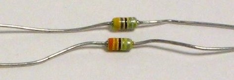

    It looks like a resistor.
