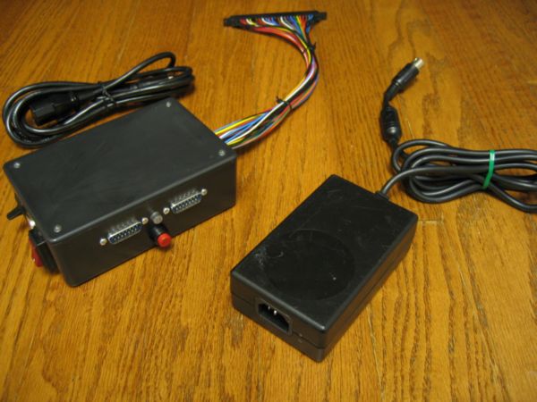

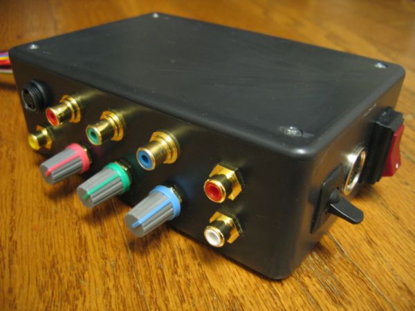

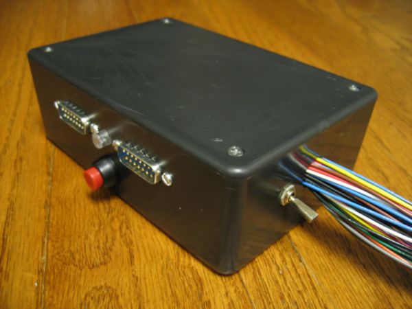

    I make superguns that do S-Video/composite using the JROK and pinned to use Neo Geo sticks and I also do superguns that output component/S-Video/composite. The typical supergun does NOT come with an arcade PSU (less amps on +5V and no -5V), instead using a tabletop PSU like the SC200 by Ault, available from Jameco. This is nicer looking and allows you to use a significantly smaller enclosure for the supergun. This does mean that some things won't work, but the list isn't big (Neo Geo Hyper64 and Neo Geo 6-slot boards come to mind). But it will power over 100+ boards as tested so far. Also, most supergun builders don't install the kick harness for CPS, but that is relatively easy.
    Here's the supergun I make, with all 3 video outputs:
    http://www.multimods.com/images/Sales2_06.jpg
    http://www.multimods.com/images/Sales2_07.jpg
    http://www.multimods.com/images/Sales2_08.jpg
    That enclosure is 6"x4"x2".
