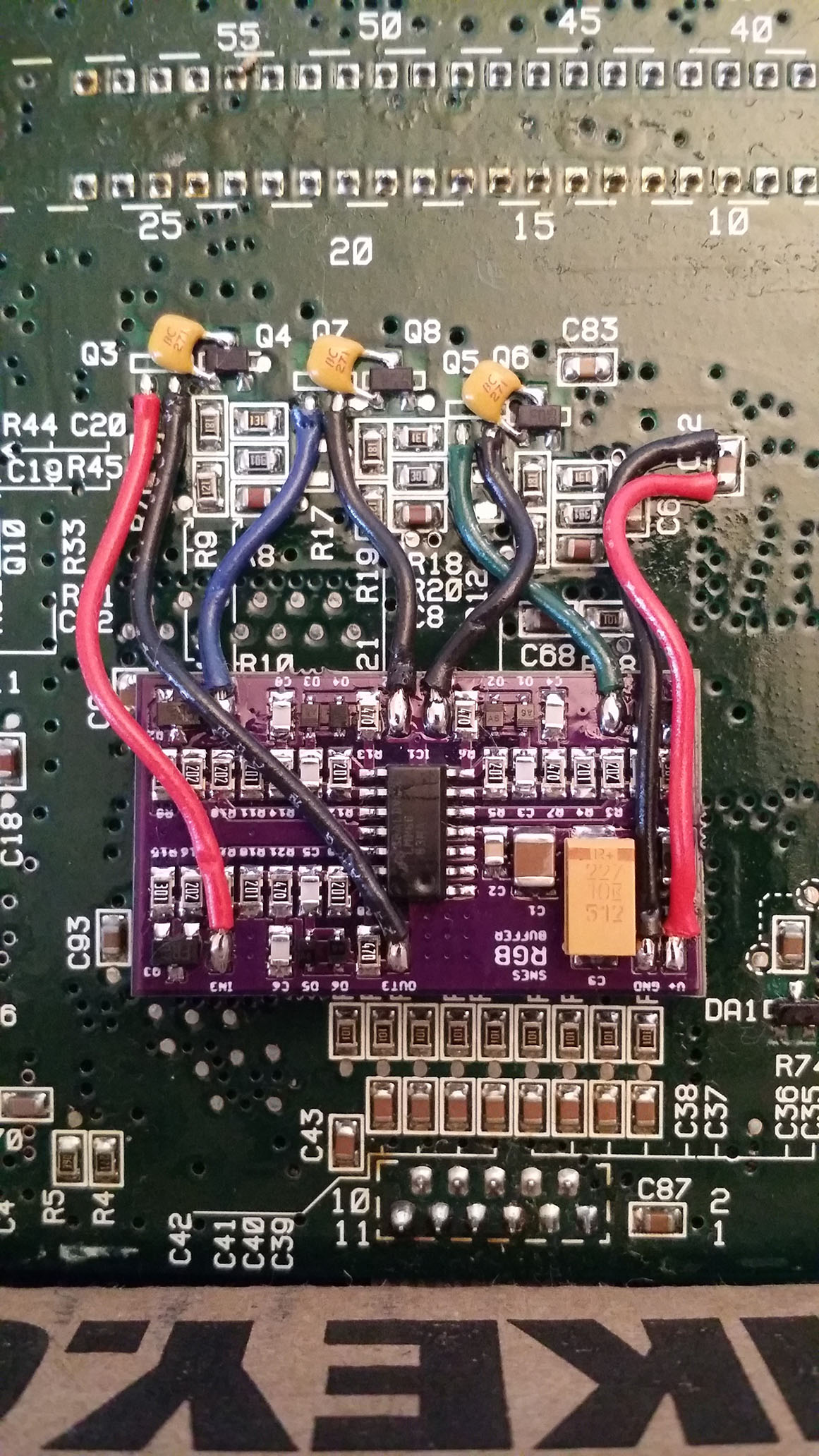

    I saw this page too from another thread here a little while back and decided to try it out. I installed it in an old GPM-01 and it really does sharpen up the edges to near-1CHIP quality and removes most if not all of the right-side blur. It's not quite perfect as it trades this sharpness for a bit of undershoot and color distortion on those edges in some cases, but that's totally minor in comparison to the large improvement in image quality.
    Here's my mod:
