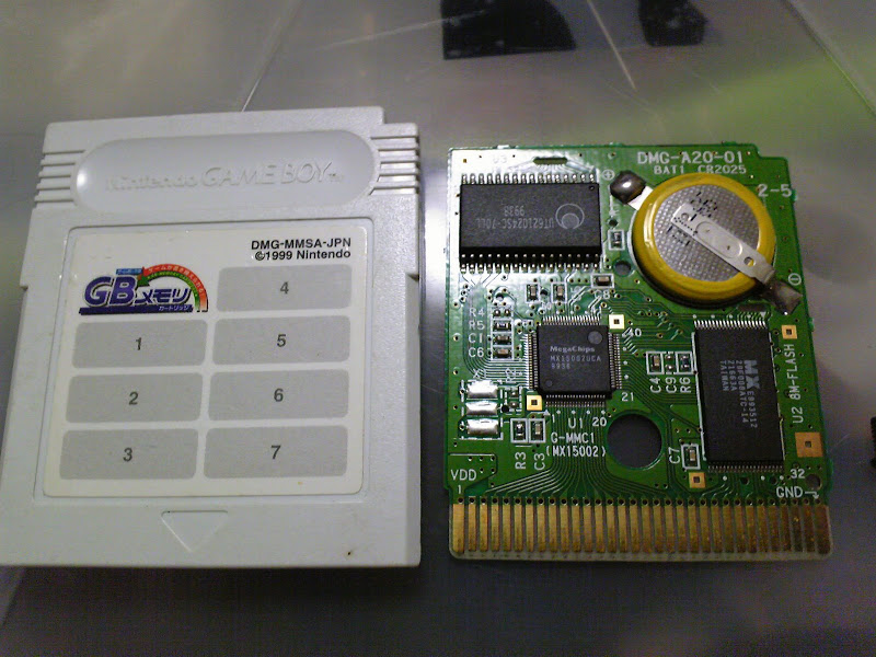

    I have some pictures of the official Nintendo Gameboy Memory Cartridge. I'll post those if anyone is interested to see. If no one else has pics of the SFC one, i'll take my cart apart and take pics of that too. For curiosities sake if anything.

    Here is the Gameboy version. You can see a huge ram chip, enough to handle a few games. As well as that Megachips IC, which appears to be running the show. Just looking at it, it appears to be doing more than bank switching. I would guess that it contains the menu as well. I didn't trace anything, but I might one day if I have some free time. Should be a rather simple job.

    Were the numbers on the cart for labeling, to tell you how many slots, or to choose a game?

    Nah the Megachips is just a mapper; it's beefy on I/O since GB needs bankswitching normally and this thing probably has a MBC5 and possibly more mappers in one plus a register file for ROM and RAM each. Games might also be modified to work directly with a MBC5 if they don't already to cut chip complexity though.
    The menu is almost certainly on the FlashROM, that's why there are 7 instead of 8 banks available for games. The config data and game name string will be stored also in the menu flash bank or in its share of the SRAM (16k! -- enough to hold the menu too and free the last 8M bank, oh well).

    calpis, thanks for the insight. I'm going to look up a datasheet for that flashROM and see where the program lines lead.
    sayin999: The numbered squares are for a little sticker with the game name. Most i've seen are hand written.
