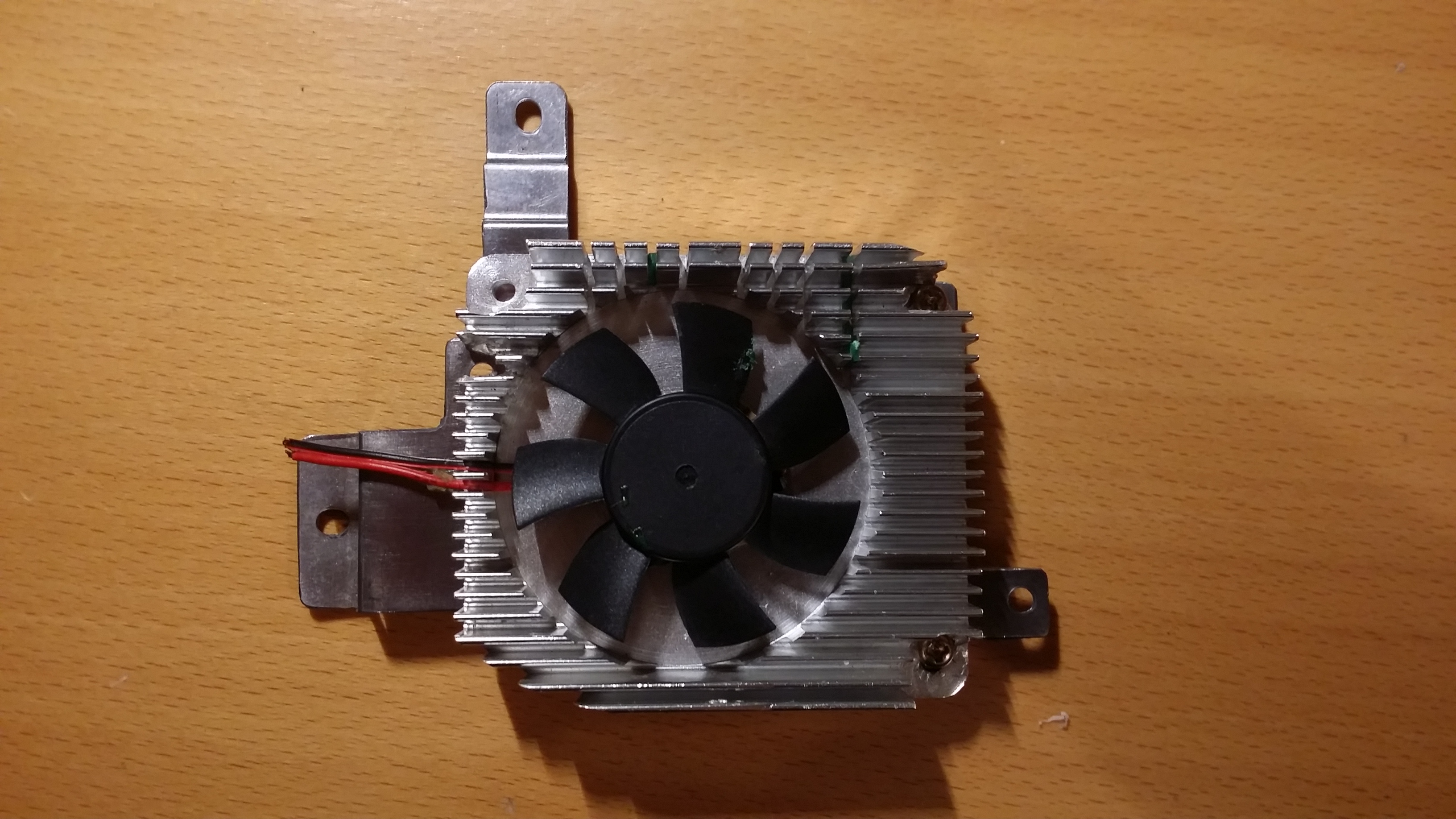

    But will use also a GPU heatsink. Fits perfect on top of the other heatsinks. Maybe i remove the stock one, but than i need some pads because the high difference from ram and CPU/GPU.

    That heatsink fits very well! I've also cut the origninal shielding plate to the size of the heatsink so I can use it to fix the whole cooling assembly with screws to the maiboard/ shell.

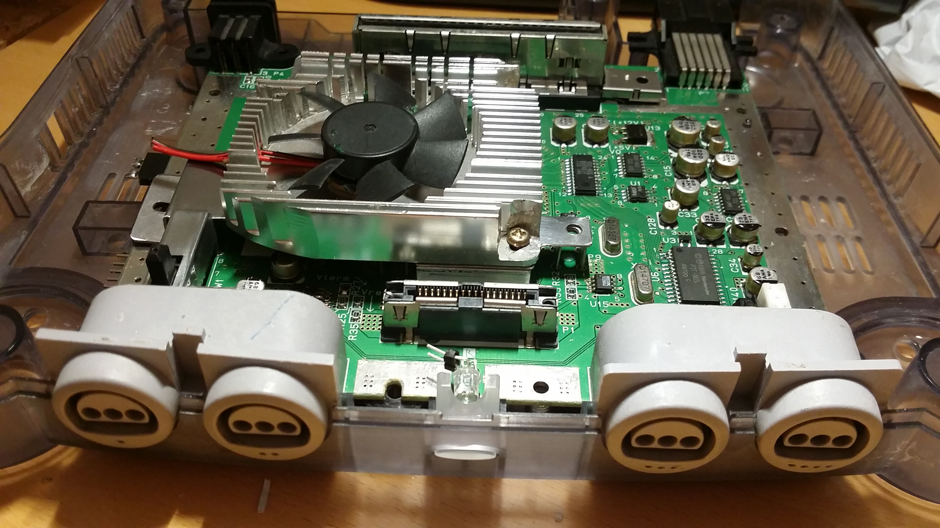

    Its a NUS-CPU-08 board from 1999 inside the midnight blue. Works great with 2.0 multi ;)
    My cooling solution is to keep the top shield, and set the heatsink with fan on top.
    Fits perfect with the top cover!
    installed a switch for 1.5 / 2.0 , changed the LED for a purpel one, still waiting for the etim RGB board.

    Installed and work fine :) still some space for the hdmi mod, when i found a kit.
    The cooling solution works great. I installed the heatsink with thermal clue on the top of the shield cover. The heatsinks from the chips got thermal paste for better connection to the top shield.
