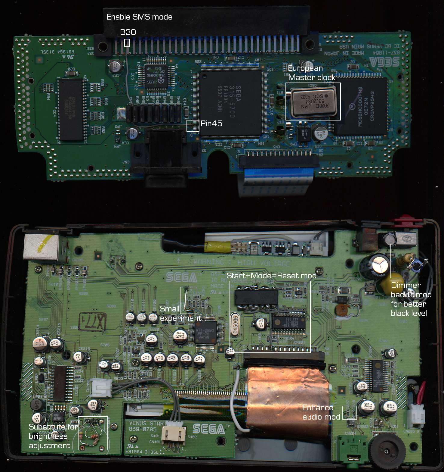

    Also these sms games dont work on my Nomad, did they remove that feature from the Nomad?

    Apparently, you need to mod your Nomad a little to get that to work. Check out this thread.

    Sorry, I didn't realize that you had to be a Sega-16 member to view threads. The mod looks easy, if you have any experience with a soldering iron. It appears you just need to connect one pin of the cart connector with one on the ASIC. So, a matter of just soldering in one wire to connect the two.

    Just to follow up—I just got a Nomad and tried this mod. It wasn't quite as easy to do as I thought it would be (due to me not being very adept at soldering); however, it does work. I now have Master System games playing on my Nomad along with my Genesis games!

    be nice if someone mirrored the photos here

    Okay, TmEE on the Sega-16 forum gave me permission to repost this here, so I've attached the image that shows the mod to enable SMS mode. It only requires soldering a wire from B30 on the cartridge port to another pin. You'll notice that there are other mods noted on this pic. If you're interested in those, I would recommend joining at Sega-16 (if you're not already a member) and checking out the out the original thread.
