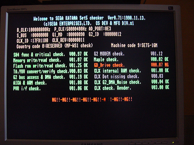

    By the fact I don't know hot to set up the unit, I instantly did your Selftest instructions. At first I thought I'm out of luck, because I got no signals from the VGA output, then I connected the S-Video and Composite cables to my monitor, and luckily those had a quite lot to show!
    I think the Selftest went through in order, but at the end it gave me some warning on the GD drive. Maybe the issue was that I didn't put any disk in for the test?

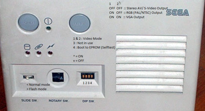

    Here is a picture of the front switches with an short explanation:
    For the rotary switch at the front of the box :

    Now for the backside of the devbox, the SCSI rotary switches are (ofcourse) for the SCSI bus.
    SCSI is a daisychain system, so all the devices connected to it are on the same cable that goes to your PC.
    Your PC will send a request to all the devices that are connected with the SCSI cable, the devices will in turn respond with "Hello this is my ID"
    The computer will then know that if it have to communicate to the Katana Debug Adapter(DA) it should use ID 3 and ID 4 for the GD-Emulator when sending a data packet.
    Normaly the rotary switches on the back of the katana are set to 4 for the left switch and 3 for the right rotary switch( if I remember correctly, dont have the devkit at the current location)
    As long you haven't changed them, they should still be in the correct setting, if not it should still work.

    Now for your selftest screen, that looks good! the reason you get a error from the GD-ROM is that you need to put an special Test GD-ROM in the box and you probably dont have one.
    You can also run some other variations of tests by setting the rotary switch to an other region ID (make sure you turn off the devkit before changing the region)

    Thanks to you, I were able to set it up right and I succeeded to get to the DC menu! then I put in my copy of Crazy Taxi 2, and it worked flawlessly in VGA mode. Looked so sharp and clean that I forget to breath for a moment =) Then I tested my copy of Sonic Adventures and that worked great too.
