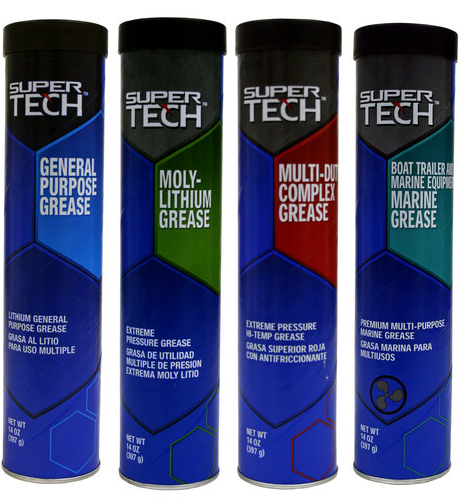

  19. alf717
    alf717 Robust Member
    Feb 29, 2008
    248
    Is any of this stuff OK to grease up a drive? I have the one with the blue label which is general purpose grease. I need to reapply grease to a PS1 laser.
