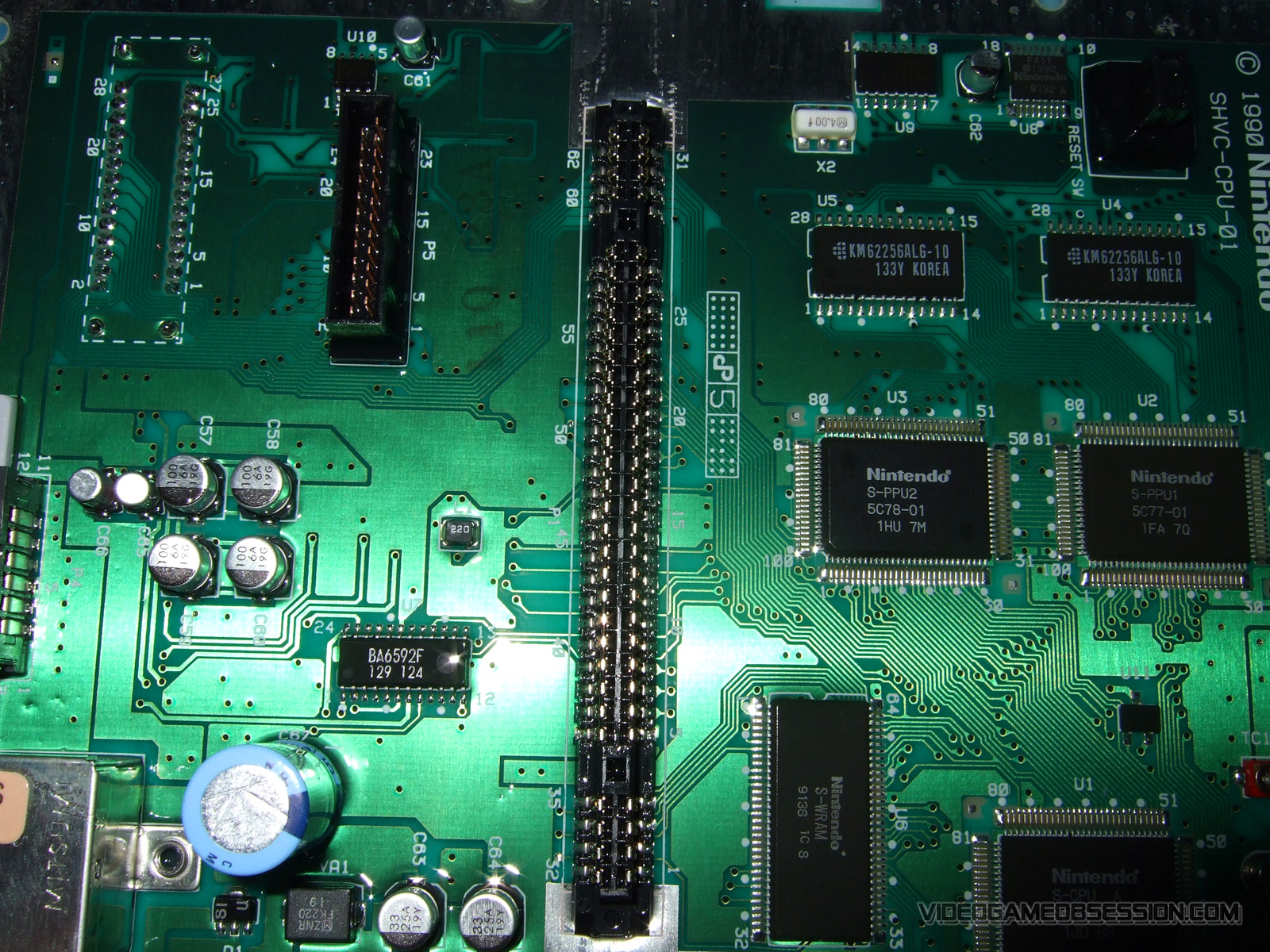

    Here are pictures of the board. http://imgur.com/a/0fjIa
    One picture shows what looks like some melting opposite of the AN78D5 and another shows some excess solder that seemed to need to be scraped off of the area around the expansion port slot. The traces seemed to all be connected fine however.

    The system boots up so it's a good start (it means primary checkup runs ok).
    I would say it looks like a video ram issue.
    I will check if all the chips are correctly welded: maybe the shock broke or lift some pins.
    Also around the BA6592 (the video output) and if you don't have a caps who take shoot around when the console fell (any deformation or not seated correclty).

    It's normal that some boards are missing the c67 cap.
    You could try and recap the whole board,did you check the s-wram chip or any of the ppu's.

    My system never had a capacitor there because I'm the only one to open the system since I got it new in 1992. Am I correct that by checking the chips you mean to check that the pins route through to the board and that the traces correctly route to the other locations properly? Is there any way to determine if any chip failed, and which chip failed, other than desoldering it and connecting it to a known working motherboard, or vice versa? Thanks!
