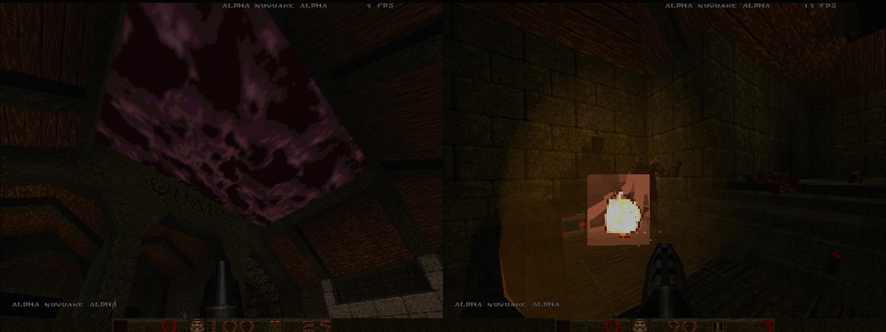

  14. TapamN
    TapamN Active Member
    Sep 16, 2005
    That fixed it.
    There's still areas with single digit FPS. Hmm.
    The frame rate issues are probably caused by CPU load. If the PVR is still the bottleneck, I suspect something is way off regarding what's being fed to the PVR, like everything is being submitted as transparent or punch through or something.
    Is there some way to get the PVR's render time? Like a console command that does:
    Code:
    pvr_stats_t stats;
    pvr_get_stats(&stats);
    con_printf("Render time: %i ms\n", stats.rnd_last_time);
    If the render time is huge, then there's probably way off with how OpenGL is submitting things to the PVR. if it's not, then the problem is definitely CPU load.
    Actually, the Neon 250 card (the PC version of the DC GPU, which is, according to a ImgTec employee, slightly weaker than the Dreamcast's despite a higher clock speed) can reach above 60 FPS on Quake, so 60 FPS should be possible on the PVR's side.
    Also, the punch through polygons aren't rendering correctly on real hardware. The clouds are missing their parallax layer, and the explosion sprites have transparent boxes around them. Probably a GL bug. For punch through to work correctly, the driver must set the blend mode of punch through polygons to the equivalent of glBlendFunc(GL_SRC_ALPHA, GL_ONE_MINUS_SRC_ALPHA). I've included screenshots.
    Anthony817 likes this.
  15. Mrneo240
    Mrneo240 Gutsy Member
    Sep 15, 2017
    462
    571
    Check gitlab, run build with no rendering . What fps
  16. Mrneo240
    Sep 15, 2017
    462
    571
    Correct .Every single polygon is sent as translucent
  17. TapamN
    Sep 16, 2005
    I'd say about 45 FPS average. I saw 38-48.
    Oh. That's... uh... not how the PVR is designed to be used.
    One of the advantages of the PVR is it's efficient handling for opaque polygons to render them with no overdraw. When you render the screen without opaque polygons, not only is fillrate wasted on hidden surfaces, the PVR will also waste its time to slowly clear its internal color/depth buffers at a rate of one pixel per clock. It doesn't have fast color/depth buffer clearing since they normally get cleared for free during regular drawing of opaque polygons. There's basically an invisible extra fullscreen quad eating fillrate.
    More than saving fillrate, if a polygon ends up completely obsured by opaque pixels, PVR seems to only do partial triangle setup on it, so it also increases the potential polygon count of the PVR.
  18. kazade
    kazade Spirited Member
    Jul 22, 2015
    155
    164
    Just to clarify, we're aware of how the OP, PT, and TR lists are supposed to be used and also aware of the slowness of using the TR list. I'm assuming that mrneo has had to send stuff as blended to get the correct output?
    GLdc selects which list to use based roughly on the following logic:
    - Send everything to OP, unless...
    - It's alpha tested, in which case sent it to PT, unless...
    - Blending is enabled, then send it to TR
    Multitextured polys (so lightmaps) have to have the second texture go through TR.
    Any ideas on how to make blended polys faster?
    GLdc certainly has unoptimised codepaths, I'd be interested to know which ones these slow areas are going down.
    If you wanna chat more about this stuff, we're all on the Simulant engine discord: https://discord.gg/TRx94EV
  19. Mrneo240
    Sep 15, 2017
    462
    571
    Fortunately that is exactly how quake is written. Now you can finally see the problem I'm having .
    I'm glad you see the issue
    Anthony817 and bulletbob like this.
  20. jollyroger
    jollyroger Gutsy Member
    Oct 18, 2008
    458
    256
    The original Quake engine would pre-combine base textures and lightmaps and store them in a texture cache, which then could be displayed in a single pass. Given that hardware that supports multi-texture or extremely fast blending don't need this, GLQuake reverted to drawing multiple passes, which is generally faster.
    The tradeoff is CPU time spent software rendering textures into a cache vs. multiple identical rendering passes, one with the OP list and one the TR list. At least this is the most straightforward way... and that is what glDc does.
