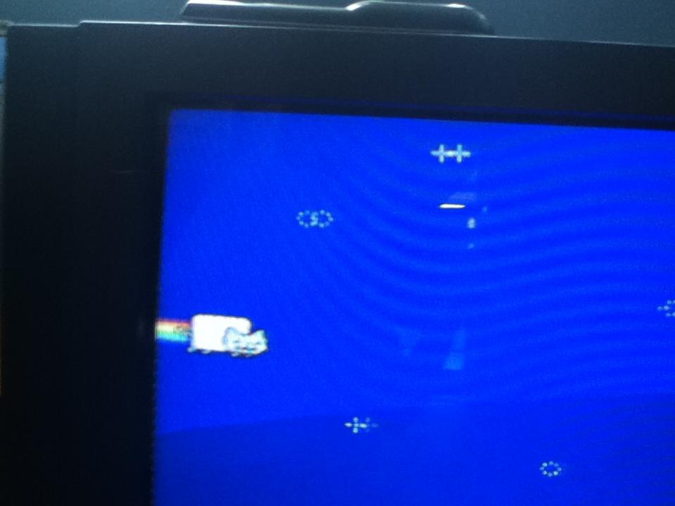

    not as good as I had hoped to accomplish, but it's my first time doing anything in 6502

    I wanted to animate the cat, but not sure I can pull it off easily.
    I'm overlaying an extra set of sprites on top of the original set of sprites in order to get past palette limitations and color everything in. I guess I could shift the tile attribute and store atleast one other frame of animation (started reaching the code ceiling for the rom size I was using). Would also like to get the stars to cycle tiles as they travel, again I'm very new at 6502 so will have to look into pulling off the tile loop
    The rainbow is a static part of the background since I had already used up my palette sets on the sprites
    I also copped out a bit on the cat since I stored him as one complete sprite rather than breaking it into different parts (poptart, head, legs, tail, etc)
  5. derekb
    derekb Well Known Member
    Jan 7, 2009
    1,964
    44
    I also had some problems with looping my animation code and instead just wrote out a long ass per-sprite thing, which is eating up alot of code space. Hopefully I can get that sorted out since it would free room for the cat animation

    I've managed to get it work on my home console :D
    If you could add some animations to Nyan cat it would be very cool
    I appreciate your work:thumbsup: Keep it on :D

    honestly biggest problem is I have no idea how to animate the rainbow with the cat, I am not advanced programmer so as-is I've already used up my sprite palettes on just the cat, I'm using background layer for the rainbow

    And i'm very sorry, 'cause i'm not a great programmer (I'm a total n00b xD), but isn't it possible to put the poptard as well as background to free some space for the sprites or how about (I hope I wasn't taken wrong) expanding the graphic space to 16kb because you've used only 8kb of CHR for your homebrew and NROM boards supports up to 32kb of CHR, so if you manage to use 16kb or 32kb of CHR then there would be enough space for the sprites ;)

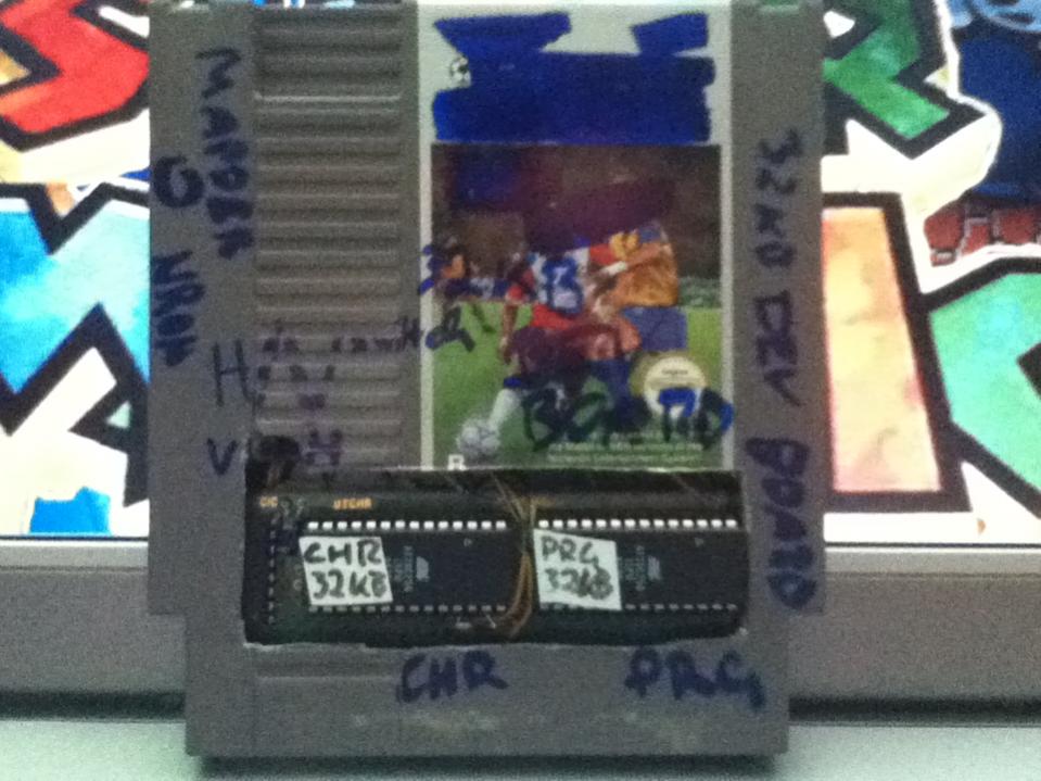

    aliman, could you give me the instructions to make that flash cart?
  16. APE
    It isn't a flash cart:
    1)Find compatible cartridge (mapper match)
    2)Remove old PRG and CHR chips
    3)Burn seperate EPROMs for PRG and CHR data
    4)Solder into cart
    5)Done.

  18. aliman
    aliman Member
    Aug 17, 2011
    yeah actually it isn't hard to make this cart ^^
    but the thing is, that you have to buy an eprom burner and they aren't cheap ;)
    it was luck that i had one lying around at home ;)
    i've wanted to do something with it and found that you could play your nes/snes homebrew on real hardware.
    if you want to make one by yourself then just google for "romlab".
    a very cool site with good instructions ;)
    my cart looks so crappy because i wanted to quickly remove the chip for rewriting and soldered in some ic sockets xD
    i'm doing one for free for our friend derekb (if he wants) 'cause he came up with this very funny and cool app that i loved from the first moment xD
    ps: for those who didn't read my full post: search for "romlab" in google, there is a very good site for making your own homebrew/developement/repro cart for nes/snes and i think atari and sega genesis (i'm not so sure)
    aliman

    looks good, main problem for me on NES is 1) new at it, 2) hardware limits that i dont know how to work around easily, much harder to work with than other platforms since its in assembly
  20. l_oliveira
    l_oliveira Officer at Arms
    Nov 24, 2007
    3,879
    245
    I'd suggest something like making the cat and rainbow with BG tiles instead of sprites, because the cat does not move around the screen (it's not a game but a demo, right ?) and you can use a advanced mapper like MMC3 to bank out the VRAM making the cat animated with just VROM bank switching. Also you can make the stars animated, but this time you would just have several tiles for them and just swap them on the name table while move them forward (as for the scroll)...
    What you think ?
