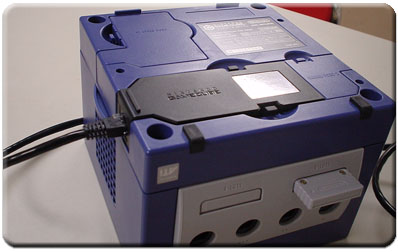

    I know that the GBA Player uses the Hi-Speed port, but it seems that the two serial ports are completely unused. I found that the Gamecube had a broadband and modem adaptor:
    ...But that only uses serial port 1. Is there anything else that uses serial port 2? Or all of the ports?
  2. MonkeyBoyJoey
    Mar 1, 2015
    1,738
    312
    The Modem and Broadband adapters are all I know that use Serial Port 1. I heard something about some dev peripheral using Serial Port 2 but nothing concrete. I would love to know what uses it too. The connector was removed from the console on DOL-001 Revision B units but the spots on the motherboard are still there from what I saw on mine. Even the case has the hole and cover that says "Serial Port 2" for it as well. No idea if the spots are still there on a DOL-101 but my guess is that they aren't. There's no hole in the case for it on DOL-101 units.
    Hopefully someone can shed more light on it.

    Commercially you have this
    Gamecube
    -broadband adapter/modem
    Now on the other side of this you have the non-retail side
    T-Dev/NR-Reader/NPDP-Reader
    -ProDG tool for the PC
