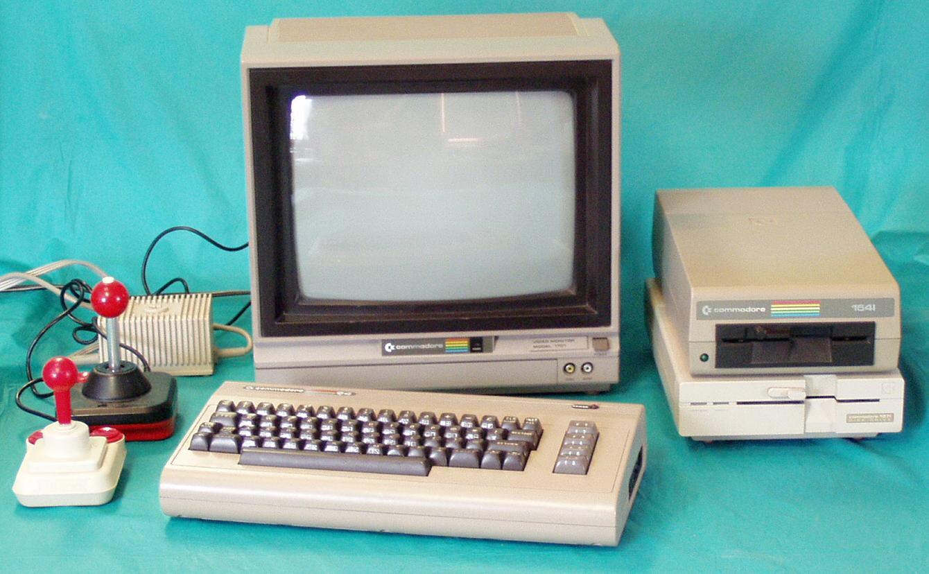

    I've had one of those before, but far from being my first PC. This was my first...
    Unfortunately I never owned a floppy drive for it, only a Datasette.

    Actually it was a brilliant OEM PC. Of course, this was when I had no fucking clue how to build one.
