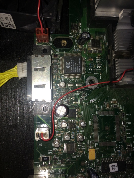

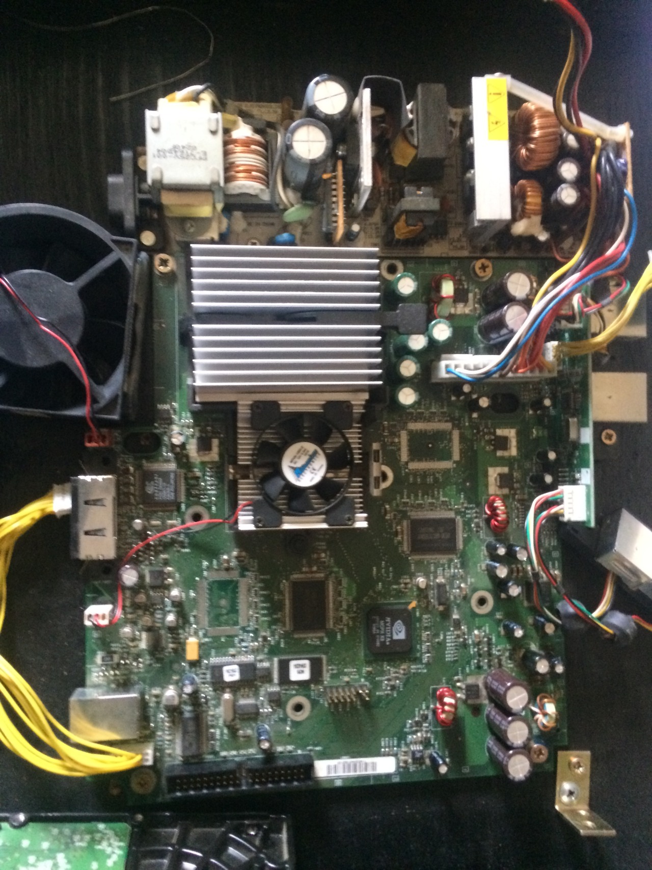

    Well after talking to my dad i gonna removing the xbox from the wooden case, reason i painted it black and maybe the paint will conduct.
    Love to make a video but will not help. simply because there is a.t.m. no video.
    But also no errors when i use my RGB composite cables to connect VGA, my monitor will not say check cable i can see that signal is active because the monitor keeps showing the analog symbol (VGA) but screen keeps black.
    Also tried Composite video CVBS on another 14'' CVBS screen, black screen audio works can here the raw sounds when the xbox boots then evodash boots and i can launch coinops thats also why FTP still is working.
    On the scart TV the original screen where i use my xbox for is scart. but already replaced the scart connector on the tv side and other consoles are working perfect that is also how i found out that my xbox is the source of the problem and all my other screens will not give any screen. There is a sync problem that is clear but its not on the software side of the xbox more on the hardware side.. Its xbox like all my xbox's are pal but this one did never got the upgrade to 720 or 1080p so its not a resolution issue.
    But gone strip the xbox from its wooden case and test it tomorrow because its to late now for that.
    Here are some pictures of the layout: but like i said gone try my dad's advice tomorrow.
    I know it would not hurt the xbox to place it on a wooden surfaces...
    Only i forgot that some paints will conduct electricity...
    And to enjoy here some pics of the working cabinet :-( :-D
