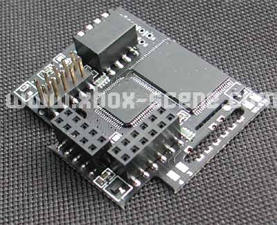

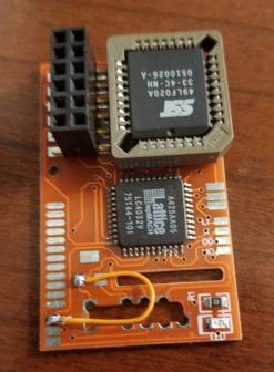

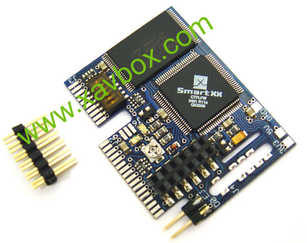

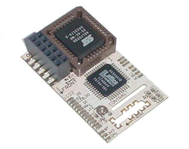

    The LPC header vias are filled with solder. You'd need to remove the solder with solder wick or solder sucker to open them up. Most, if not all, v1.0s were made this way. Many modchips were made as a quick solder board (QSB) to lay on top of the LPC header and tack all the points with solder to connect to the LPC contacts necessary to operate.
    The section on all these boards closest to the bottom of the pictures with solder pads around open slot. These modchips also provide installation via an header installed into the LPC debug port of the Xbox.
    Photos are from various sources across the Internet. Some are watermarked as to their origin.

  20. brirec
    brirec Active Member
    Jun 3, 2016
    33
    The red one shown second from the right is an Aladdin XT Plus2 (the super cheap one). If you want something a little fancier and don’t mind paying a little extra, the member here BennyDiamond designed his own modchip called the Xblast Lite: https://www.assemblergames.com/threads/xbox-fs-xblast-lite-v1-pre-edition.58923/
