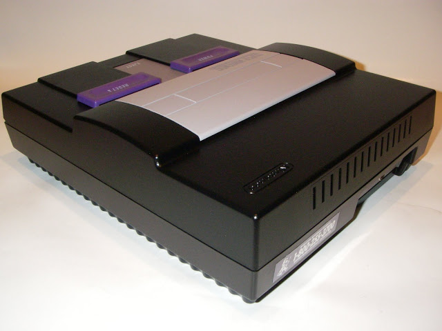

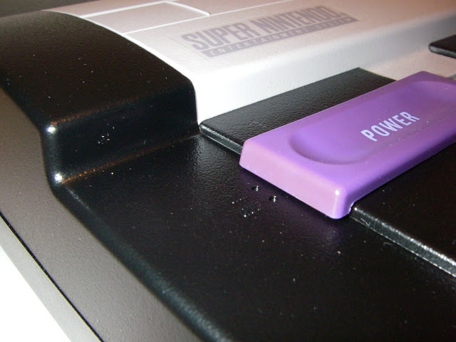

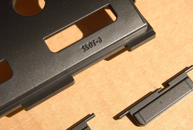

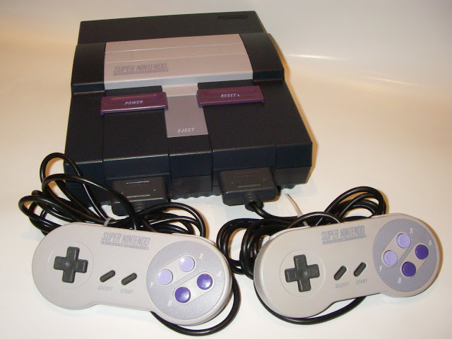

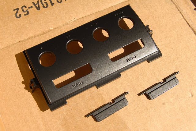

    My personal favorite is "vinyl dye," which actually briefly alters the plastic so that a true dye can penetrate the plastic and permanently stain it.
    It gives a "no-relief" finish, can't scrape or flake off, and looks terrific.
    Here's some units I have modded (the "specks" you see are small dust particles that settled on the surface and are reflected in the flash. The finish is actually quite smooth, and flawless) - -

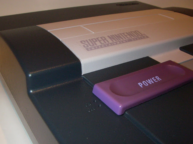

    And, a grey one - -

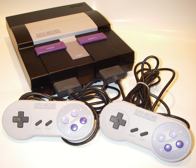

    Works great on GAMECUBE front plates, too - -

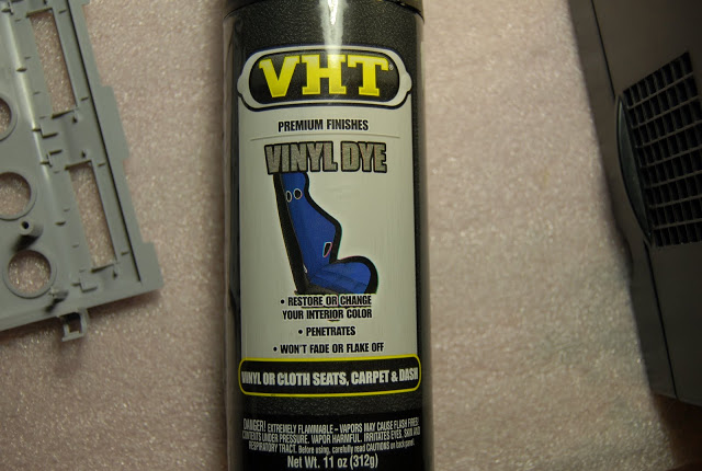

    And, here's the product I use, "VHT Vinyl Dye" - -
    Great stuff, highly recommend it.
    Wear a respirator, take precautions. This stuff is seriously toxic. Smell fades from painted objects in a week or so, and it looks and feels like manufactured plastic.
