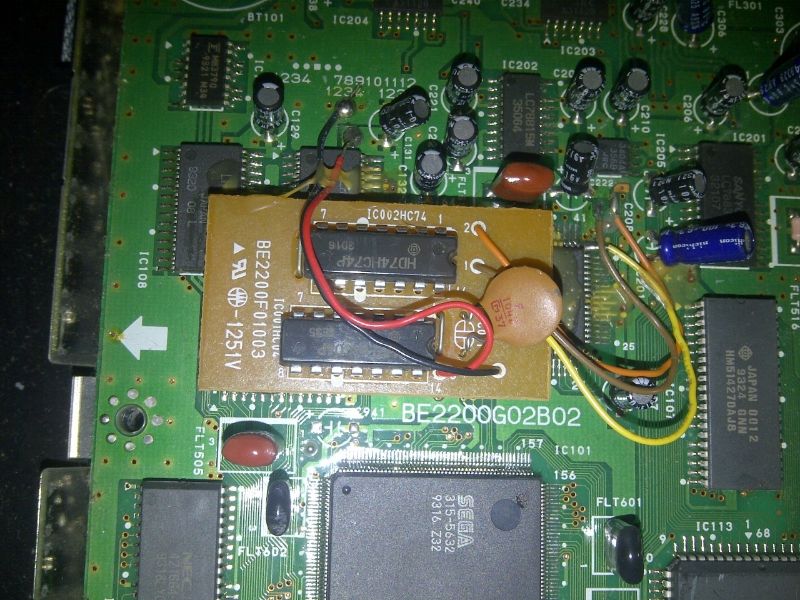

    I received a model II mega CD as payment for fixing a dreamcast for somebody, it all seems to run fine.
    Just for the sake of curiosity, I decided to crack it open and have a look and on the motherboard. I then spotted this.
    Is it anything interesting? because it doesn't look very stock

  3. pas7680
    pas7680 <B>Site Supporter 2014</B>
    Jun 20, 2008
    276
    didn't someone post about this last week??? yes it's a standard part, mine has one too.
  4. Zer0-2k11
    Jul 18, 2012
    542
    Same. Had to replace the fuse in my Sega CD II and i seen the same board. Long story short its manufacturer done.
  5. Hedgeyourbets
    Jul 19, 2011
    743
    Ok Fair enough! Just thought the soldering looked a bit amateur to be factory done is all!
  6. omp
    omp Familiar Face
    May 22, 2011
    1,017
    Yes it is in early model 2's (from memory the service manual makes reference to it).
  7. APE
    D flip-flip and a NOT gate. Nothing major but without knowing what they connect to I've got no idea what they're for.
  8. sonicdude10
    Jan 17, 2012
    2,573
    I posted a picture of this too a while back. From what I was told it fixes a bug in one of the ASIC chips. Not sure what or how though.
  9. lord_raymon
    lord_raymon Active Member
    May 18, 2012
    Is connected to PCM sound chip.
