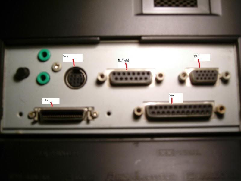

    Thats the main bunch of ports. The only other way of connecting a drive that I can think ofother than those are the pc card ports on the side.
    So from what your saying from the sounds of it if I did have a 5" drive hooked up I'd have to go into dos from windows and type a command in? In other words the games wouldn't boot after starting the computer up?
    Do all PC-98s do this?
    The 'printer' port has 36 contacts in it, that it?

    I think your "printer" is actually SCSI and your "serial" is a printer port.
    I would not spend anymore money on this computer, you need a mid 80's PC-9801.

    5,472
    Yeah the 36 pin port is a SCSI port and you can connect a 36pin external floppy drive to here.

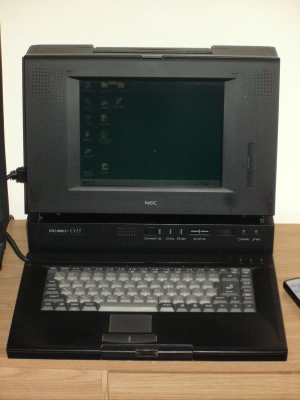

    The CR-13 is a nice looking machine, a bit ahead of it's time with a LCD screen and detachable keyboard but with a great look.

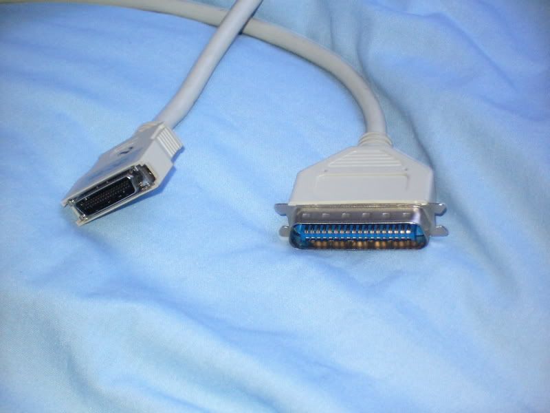

    The ports are deffo labeled correctly - the printer that came with it hooks up to the 36 pin 'printer' port. Uses this cable which looks like the connector for a external drive on the device end of it:
    It is indeed a very nice machine, lcd scrren, 4 cd multi changer, keyboard & touchpad and folds away nicely (good as I have no space for an rgb monitor)
    Just noticed there is a Logitech SCSI application on the computer so I presume your right about the 'printer' port.

    SCSI also uses both DB25 and Centronics connectors, just like parallel ports.
