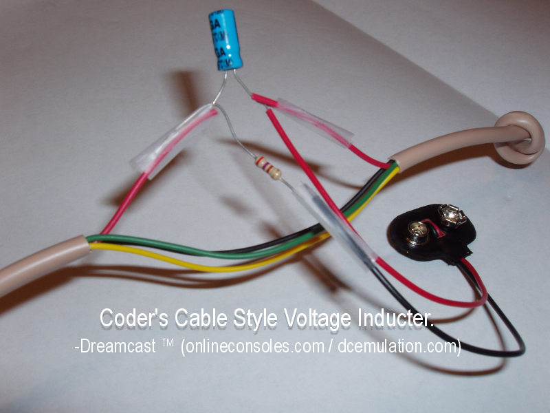

    I live in PAL territory therefore i have a PAL dreamcast, and of course a PAL modem, now i have configured everything for a pc-dc server, but has you may know the PAL modem requires a Line voltage simulator, and my question is simple is there anyway possible that i can pass a line voltage simulator, i simply cant aford one, and in my country is very hard to find any electronic parts to make one, belive it or not our hardware shops dont sell things like capacitors or resistors.

    wow that is alot of money, im in the process of building a line voltage inducer, just need to get the resistance and il do something like this.
    http://www.onlineconsoles.com/content_images/dc/voltinducc.jpg

    ok guys so i have made my Line Voltage Inducer
    its not perfect but i tell you setting up a SMD resistor is hard has crap, anyway i have tried to connect but my win98 vmware machine just stays in monitoring fase, is there anyway i cant test out the LVI.
    PS: i was using dreamkey and i have added the blind dial option (ATX0), on the DNS i have "automatic"
    EDIT. so i tried to test out my cable on my phone, so i plugged both ends one on the wall and the other on the phone and:
    without the 9v battery it wouldnt work.
    with the 9v battery worked fine
    the cable only plugged into the phone with the 9v battery it would not work ( i dunno if its supposed to)
