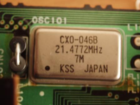

    Doing a repair on a PC Engine and need to get my hands on a 21.4772MHz crystal oscillator.
    If anyone has one from a junk console or something like that I would be interested.

    That's just a crystal.
    I need need a crystal oscillator exactly like in the picture.
  4. Bad_Ad84
    1,311
    They are both the same thing.
    However you just need an SMD one (that looks smd at least from the pic) or just wire the one I linked to the pads.

    They aren't the same thing, the SMD one has the Crystal + the required circuit in one package, the one you linked in digikey only has the crystal.
    If you can't find the Crystal Oscillator, you can also build a simple circuit using a regular Crystal.

    Thanks for that Feder. Do you have any links to a circuit to build one?
  7. Bad_Ad84
    1,311
    Like 2 caps
  8. Mamejay
    Mamejay Robust Member
    Sep 19, 2010
    258
    I think its more that a couple of caps. If you have a circuit diagram to explain it that would be great. The ones i have seen use IC's, caps resistors etc.

    I've only ever dealt with oscillator circuits for Microprocessors. Which are just 2 caps - hence my original "they are the same". However, now I am at a computer (rather than in bed on my phone) it would seem by googling there are multiple different types for projects I have never done.
    My example:
    I suppose the best idea would be to get the datasheet of the part you took a picture of, the datasheet will give you a diagram explaining the internal circuit - which you can copy.

    I have been killing myself trying to find the datasheet
