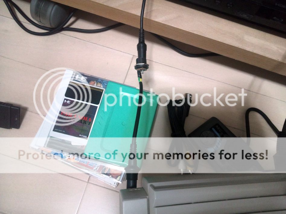

    I just bought a Japanese Duo-R and I use a Japanese Mega Drive 1 PSU on it with an adaptor to change the end socket size as the MD socket size is too big. Check it out below.
