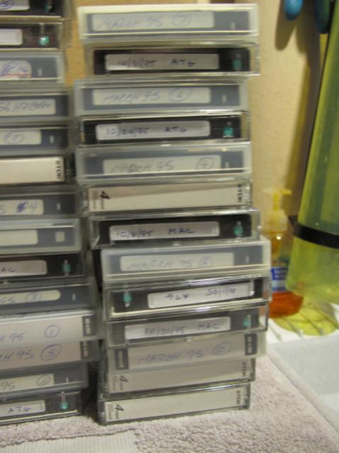

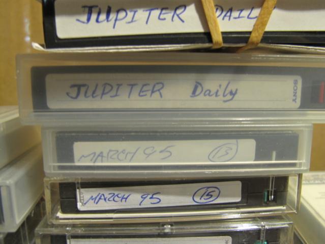

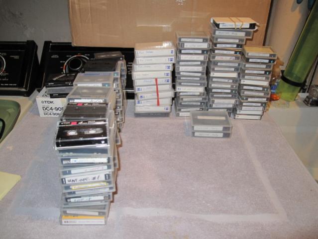

  1. ASSEMbler
    Here's the first batch of tapes.
      File size:
      39.7 KB
      Views:
      1,186
      File size:
      35.2 KB
      Views:
      1,149
      File size:
      22.7 KB
      Views:
      1,163
      File size:
      47.3 KB
      Views:
      1,152
      File size:
      32.8 KB
      Views:
      1,156

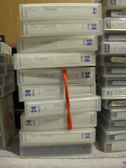

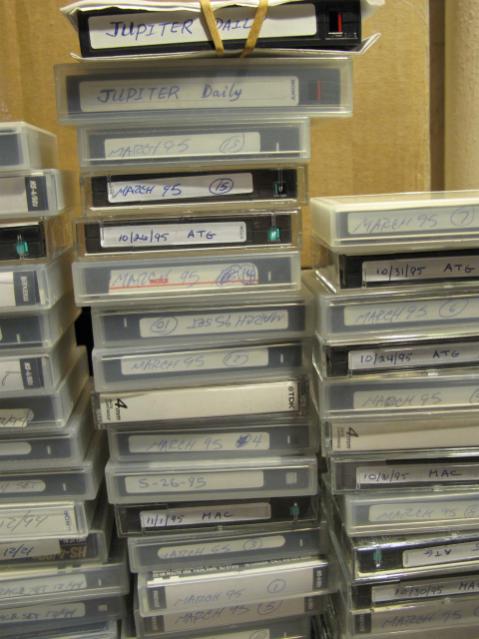

  2. ASSEMbler
    more
      File size:
      47 KB
      Views:
      1,122
      File size:
      36.8 KB
      Views:
      1,122
      File size:
      37.1 KB
      Views:
      1,130
      File size:
      41.1 KB
      Views:
      1,131
      File size:
      36 KB
      Views:
      1,124

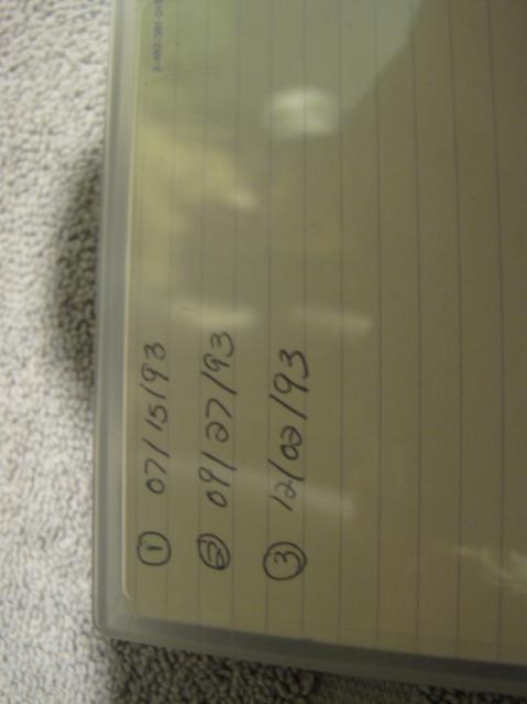

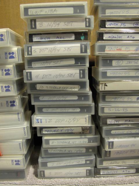

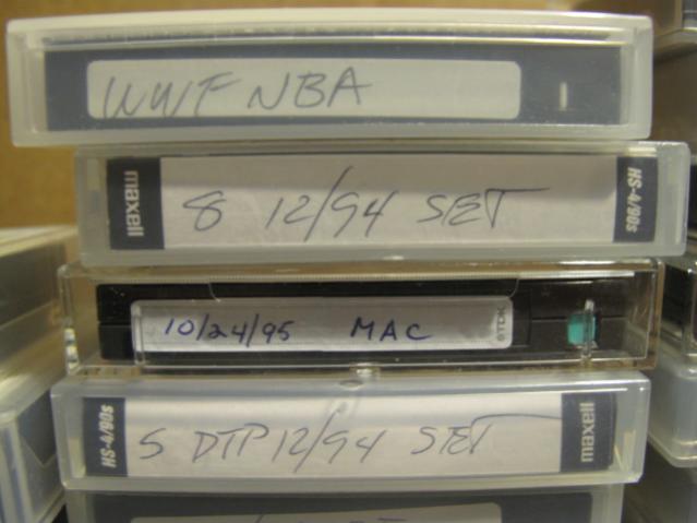

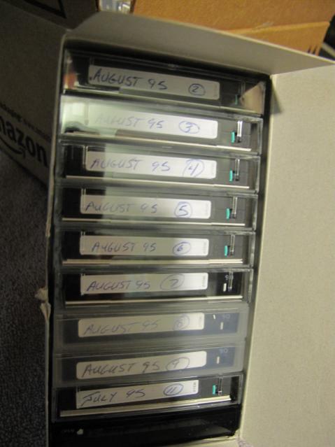

  3. ASSEMbler
    more 2
      File size:
      37.7 KB
      Views:
      1,125
      File size:
      44.2 KB
      Views:
      1,129
  4. ASSEMbler
    Now I just need to find drives...
    I am also worried that they are spanned. I have perhaps a few sets that are together, the rest are all loose.
    Can spanned volumes be read individually?

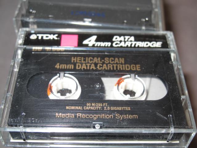

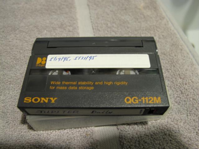

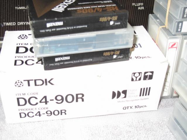

  6. retro
    It may be possible to do a partial recovery of spanned tapes. Yes it depends on the method used to archive.
    There are a lot of DDS tapes there (original, 2gb capacity) and a fair few D8.
    Finding the drives is the easy bit... then the fun starts!

    @Assembler - Where did you get these tapes? There is a ton a good data on them just by looking at the titles and labels written on them.

    As for the question about size, they aren't necessarily full, but you have to remember that each of those tapes holds 2Gb / 2.5GB UNCOMPRESSED, so could be compressed to hold twice that. One tape could have 5Gb of data or 500Mb. We don't know.
