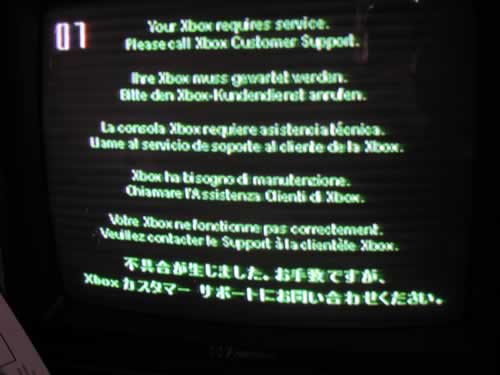

    Which error message is it giving you?
    Assuming it's like this screen:
    What's the number at the top left?

    Code 09.
