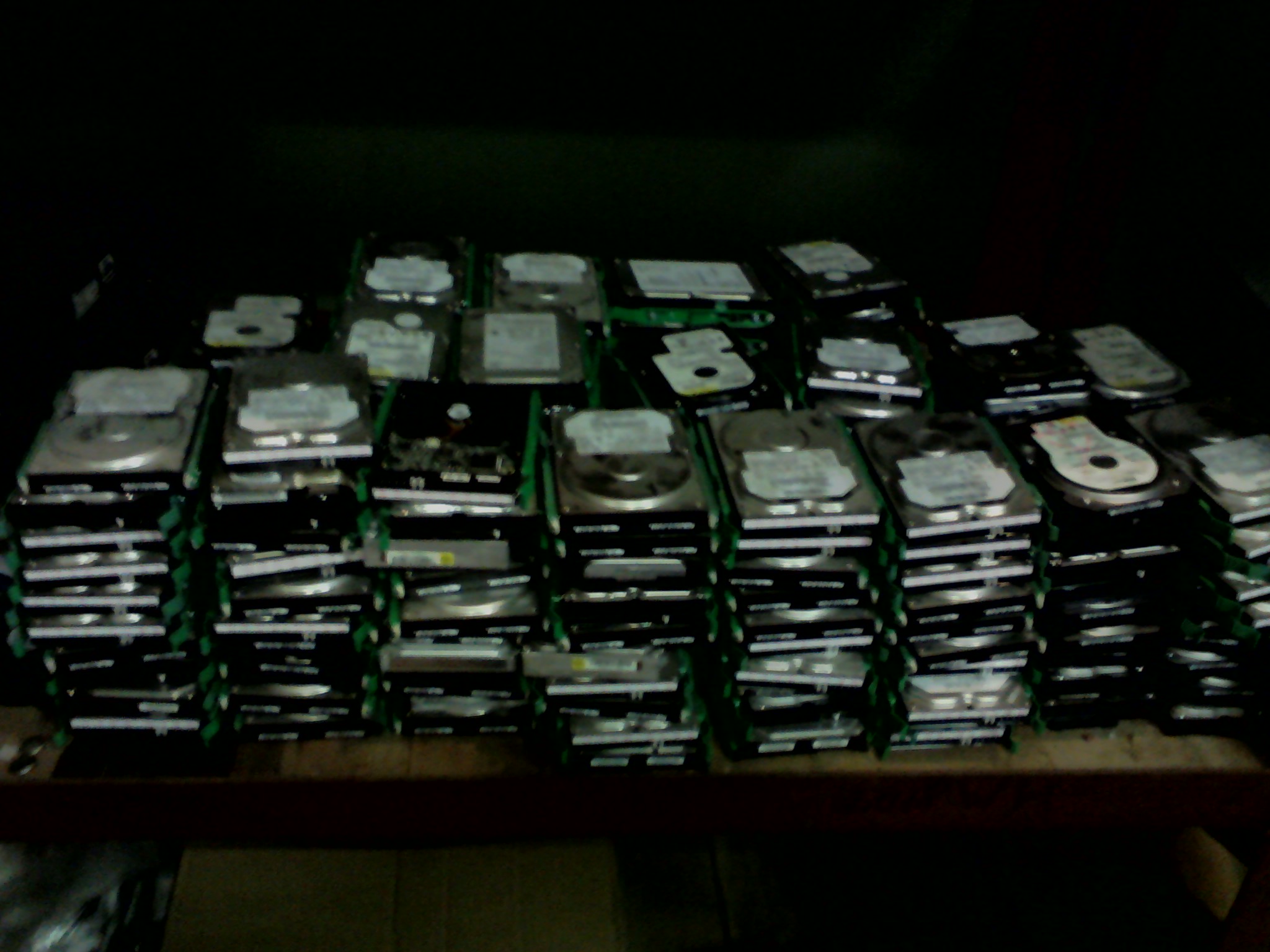

    Look - here is simple example [​IMG] [​IMG] of how to exploit Fat PS2 without Memory cards, joypads or dvd disks. Only Network adapter+2Gb hard drive, only hardcore.
    Look here is my hard disk drive collection.

    Did you steal them from some 200x cloud storage server closet ? :biggrin-new:

    not server )) normal office machines :p but yea from 200x
