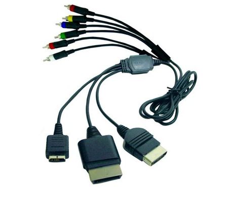

    try PS Component cable and connect them to PVM's BNC connectors.
    You may also need the breakaway(?) module to get the sync signal too

    This type of cable might also work, depending on if the PVM will accept composite video for sync.
    If it doesn't you will need a sync stripper.
    Of course you will need to purchase some Phono>BNC adapters.
    I have a Mitsubishi monitor this might work on and this cable. I'll give it a try next time I'm able to.
